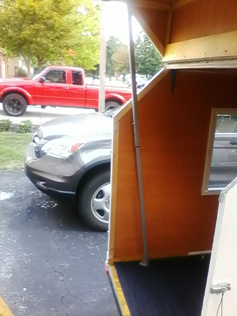

Postby Tomterrific » Fri Sep 04, 2015 5:55 pm
I stressed over how I would make my hatch struts. In the end I used a damaged leg from an EZ-UP canopy. Now I need another but it should not be difficult as I've seen several in the trash at camps. In my case, I merely sawed off the top to size, drilled a hole to screw into the hatch and screwed the foot of the prop to the floor. I lift the hatch up and the prop/leg extends, then the spring loaded button clicks holding it securely. Easy peazy!
TomT
