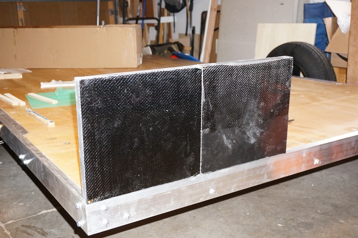

StrongFeather wrote:With Panel #2, I used one layer of really thick, heavy 18oz fiberglass cloth instead of two 7oz. layers. I thought I could get away with not using flow media on this one because the 18oz cloth has such an open weave - wrong! It did infuse, but it was extremely slow and needed some help from a plastic spatula to get the resin to the edges. Lesson learned. I also brushed in a gel coat on the top half of the panel prior to laying the fabric just to see how it comes out. I also used a fiberglass veil on the left half. The weave pattern of a course fabric, like the 18oz., may show (print) through the finished surface - a veil is a thin matting that is supposed to prevent this "print through".
Panel 2 is out of the mold, so I thought I would share some notes...
The finished surface came out somewhat cloudy because the glass was somewhat cloudy when I started. The cloudiness came from the Frekote 770NC Industrial Mold Release, which is supposed to be "the best", but clearly something went wrong. Although the glass was cloudy looking, I did buff it with a cloth beforehand, so it was smooth. I wanted to see if it the cloudiness would still imprint onto the part, and if so, how much. The answer is completely. Now I have to figure out what I did wrong.
Also, the 18oz cloth pattern did not print through any part of the panel, either with or without the veil. This is significant because now I know I can use 1 layer of 18oz fiberglass ($5 / yard) instead of 2 layers of 7oz ($7 / yard). I was also worried about the 18oz cloth adding weight due to extra material and resin, which turned out to be a non-factor. Panel #2 is only 10 grams heavier than Panel #1, and considering that #2 is 12 square inches larger, I would say the weight is a wash.
Finally, the gelcoat that I brushed on seemed to work just fine, other than the cloudiness mentioned above from the mold. It covered well and looks like brushing it in will work, but I'll make the final determination when I fix the cloudiness and see how it turns out.

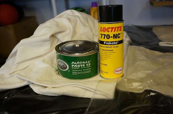

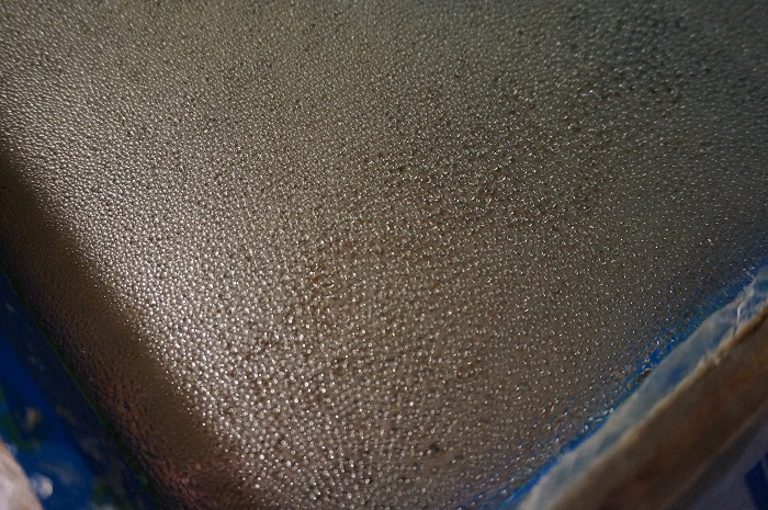

Finally time for another update. It's been a while because I was waiting on some supplies that were in the "large" order with all of the material needed to make all of the panels for the trailer. Unfortunately, instead of coming on Friday, like I hoped, it didn't arrive until Monday and Tuesday. That's a great way to kill a nice long weekend of testing. Nevertheless, I didn't exactly expect the prototyping process to go smoothly, and to be honest with you, I'm relatively pleased with the progress thus far.
So, after finally getting everything together, I was able to strip the old mold release out of the mold (which is what caused the matte finish on panel #2) and reapply a much thinner coating. It looked great, which meant I was ready to test apply the in-mold clear coating (another part of the large order that was delivered late). I set up my new HVLP spray gun - a mid-level gun from Amazon - and was not happy. The spray was pulsating in a bad way, rather than a nice continuous spray that you'd expect from a spray gun. I proceeded with the test anyway because the clear coat was catalyzed and in the gun anyway. The result was not a smooth continuous layer, but a bunch of tiny droplets that beaded-up on the mold surface. Failure! Since I couldn't rule out that the gun's pulsating spray caused this, and since I needed another new gun anyhow, I went to Harbor Freight and picked up a $15 gun. After removing the first layer of clear from the mold, and setting up the new-new gun, I sprayed the second test... same result. Here's a picture. There is actually zero clear coat between the individual droplets.
Shot off an e-mail to Hawkeye Industries tech support, which meant another delay, but it looks like the problem was the mold release. I tried hard to use the very best products in nearly every aspect of building these panels, and as a result, I selected a semi-permanent release agent Frekote 770NC rather than a traditional paste wax. As it turns out, 770NC is just too good. So, I stripped the mold again, waxed it with Partall Paste #2 wax and resprayed the mold with clear coat.
Here's a picture of the culprit and the savior; new-age vs. old-school...

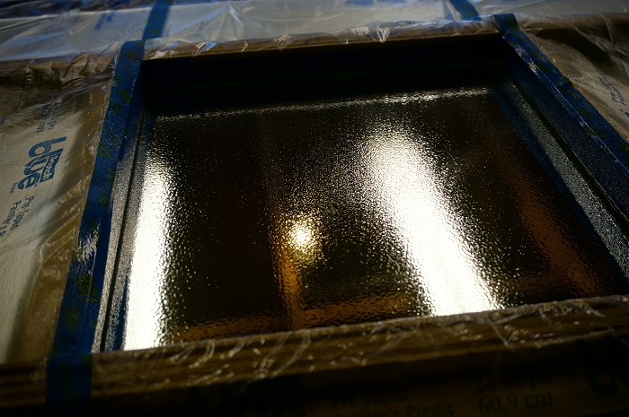

And a picture of the (hopefully) successful clear coat application. There is a quite a bit of orange-peel, but I don't think it's bad enough to print through or disturb the carbon fiber pattern. We'll see tomorrow when panel #3 gets pulled from the mold.

I pulled Panel #3 from the mold today and I really like what I see. The clear coat worked great! It's smooth, flat and shiny as I hoped. This is significant because the clear coat protects the epoxy from UV breakdown, adds shine, is more scratch-resistant than epoxy, and can also be wet-sanded and buffed.
The only problem that I'm having now is kind of a minor post-mold issue that doesn't affect the final part. The "mold" - in this case - is a sheet of glass with a frame sitting on top. Here's a picture of the prototype mold so you have an idea of what I'm dealing with. The production mold will be glass from a sliding glass patio door and 1"x1.5" rectangular aluminum as the frame rather than wood as I used in prototyping.
The issue is that I'm using gum tape between the frame and the glass, and since the tape is about 1/16" thick, it creates a gap between the frame and glass. If the gum tape is too close the inside edge of the frame, it'll squish into the part. If it's too far away, the epoxy will cure under the mold frame, mechanically locking the part in the mold. I used modeling clay to fill the gap on Panel #3, which worked well, but it's soft and comes off on the part. Like I said, it's kind of minor, but the clay would have to be cleaned off of each part and that takes time.
If anyone has suggestions on other ways to seal the frame to the glass, I'm all ears. The gum tape, in spite of its thickness has several advantages - it creates an air-tight seal, it is not permanent and it does not contain silicone. One thing that I'm considering is sealing the mold frame to the glass on the outside perimeter (with the frame sitting on the glass) rather than underneath it. This would get rid of the gap, but it could end up being a PITA when trying to pull a vacuum. Something to ponder, I guess.

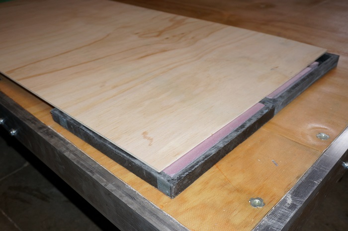

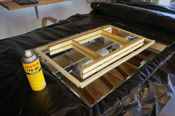

I’m not the best at ‘splainin’ things, so this might help explain how the mold will work. Below is a picture of the mold frame pieces laying on a 3’-wide heating blanket (I don’t have the glass yet).
And this is how I hope to make smaller pieces without having to cut the frame pieces shorter and shorter and shorter and oops no more frame to cut shorter.
I also hope to seal the bagging film to the top of the frame, but I realize that I might have to just go from the glass, up and over the frame. The key will be getting the frame sealed to the glass.
This is definitely a moving target and who knows where it will end up. I’m open to all ideas and suggestions to figure this out and improve the process or tell me when I’m messing up royally. Join me on the ride and we’ll see where it takes us. In many ways it’s about the challenge to do something different, solve some first-world problems and have fun doing it. If it turns into a new and innovative way to build a camper, great! If not I’ll still have fun doing it.

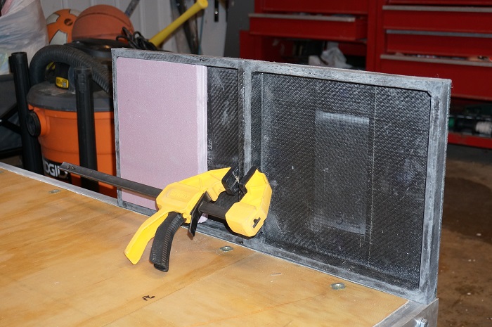

That last post made me realize that I need to get better at explaining... and showing my thoughts. I know that I can ramble on at times, so I usually try to keep things short (believe it or not) to maintain interest. I'm not a gifted writer, so I should probably rely on pictures more than words.
With that said, I decided to use a couple of the prototype panels to mock-up a small wall to show those that may actually read this, how this concept is supposed to work.
After the individual panels are made, they will get glued together (with epoxy) to form a wall. The glue in the case of this picture is the clamp. Once the wall is assembled, XPS foam will be glued (also with epoxy) into the interior cavities. Note that the picture only shows a partial foam because it was a piece I had laying around.
It's not a great picture, but the outside will look something like this.
And finally, the interior will be skinned with whatever. I'll probably go with 1/8" baltic birch if I can find it locally.
The end result should be an incredibly strong and lightweight structure that (hopefully) looks pretty cool too.
