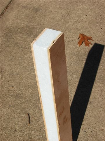

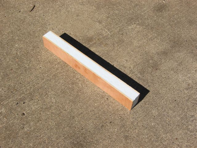

Last night I tried the following, motivated by the thread I had just read.
I took a couple small scraps ( 3" X 24") of 5.2mm luan panel and cut a similar size of 1.5" thick DOW blueboard (Extruded Polystyrene or XPS). I moistened one face of each plywood with a damp rag. I lightlty ran some 120 grit sand paper once over both sides of the blueboard to roughen the surface and I wiped the faces off with the damp rag. I buttered both sides of the blueboard with a thin layer of Gorilla Glue (polyurethane based) and made a sandwich between the damp faces of luan. I clamped and went to bed.
This morning I unclamped and wow! That son of a gun is strong. I span about 18" between two chairs and stand on it with one foot. Hardly any deflection. I don't know how it could bond much better,
Now.... am I missing something or is it really that easy to build a composite panel? I had been experimenting with pouring the foam but this seems equally as strong, and less messy. The glue is expensive but maybe it can be purchased in larger quantities cheaper.
I will try the same experiment with beadboard (white expanded polystyrene - cheaper) and see how well it works. Also HD had a pink XPS 2" foam board (FomulaR) for less than half the blueboard price so I may try that too.
I figure a 4' X 8' panel would cost $22 for two sheets luan, $ 12 for the foam board, and $8 for glue. Thats $ 42 per panel.

Regardless of clamps, vacuum, or water. The main issue is that the pressure MUST be equal across the whole panel. Simple Clamps do not do that, Vacuum does, as does water. Capt., the HUGE steel plate that Thermacore uses is making sure that pressure is exerted evenly so there is not chance for delflection on the surface, even though it also exerts a tremendous amount of pressure. The structural integrity of a SIP is measured at its weakest point.
The reason for the water pool notion in the previous thread was because the point of that thread was how to do it as INEXPENSIVELY as possible. I certainly agree with you that vacumm wouldbe better but it would not be as inexpensive.

Postby captainsam » Sat Mar 18, 2006 5:37 pm
Guy wrote:Dear Capt,
BTW, you are not missing something when you calculate the price. About a year and a half ago, Jamie at Happitrails felt his price was somewhere in the 1 dollar per square foot range.
As a newbie I don't have the advantage of what has gone on here before... does Jamie make or buy his panels for $1 per square foot? If he buys them, where? What are the facings and cores he uses?
Here are few photo's of my latest tinkering:
About 3" X 20" X 2" thick
5.2mm Exterior Luan and 1.5" Dow XPS (Blueboard)
Made with Gorilla Glue
Bending but not breaking

Great work on that SIP.
Jamie made his own SIPs.just like you.
In order to make curved SIP you will have to use a type of foam that Curves with heat, or pour your own into molds. Using jigs such as those used in the plywood bending industry which maintain equal pressure across the entire surface so there is no deflection or dimensional variation. BUT you are certainly doing well.
