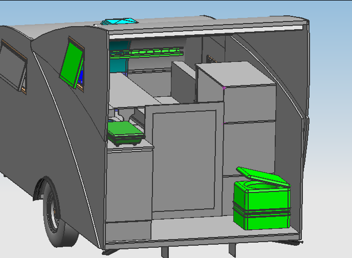

Guys if the door bothers you just put it going the other way. That way it opens to the inside of the TTT.
Trackstriper wrote:I keep trying to figure out how someone accesses the loo without opening the rear door of the trailer
bledsoe3 wrote:They always say our little trailers are never done.
Trackstriper wrote:I just knew that even I couldn't fit in the small remaining corners while the doors were being opened.
Trackstriper wrote:I really think you'll like the indoor shower.
Trackstriper wrote:It has a transverse bunk (for one) and a combination shower/porta-potti enclosure that has served me well for a couple of hundred nights on the road, typically for a week or two at a stretch.
Trackstriper wrote:I do have a very small, brushless 12v centrifugal blower fan to continuously vent the enclosure to the outside. This helps the enclosure dry quicker and I have no moisture issues. It also helps with any odors from the potti. Something to consider, especially when sharing the Puffin!
steve wolverton wrote:Trackstriper wrote:I do have a very small, brushless 12v centrifugal blower fan to continuously vent the enclosure to the outside. This helps the enclosure dry quicker and I have no moisture issues. It also helps with any odors from the potti. Something to consider, especially when sharing the Puffin!
That is something that I need to add. I'm not sure the best route to do it though. The Puffin uses 110v, and I don't want to run a transformer, so I'm going to have to add a small exhaust fan. I'm guessing I'll just use a regular house bathroom exhaust, but that really seems overkill for a 30" x 36" closet. It would keep it dry in there though.Right now I have two 5" vents. I have one at the top of the bathroom and one at the bottom. Thanks for your input, I appreciate it!
