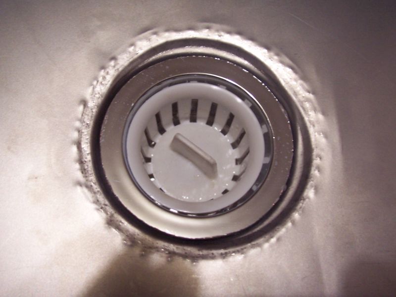

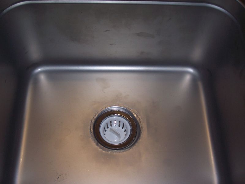

It really works!!!! I was fooling around with our company's green lee set tonight, and decided to see if I could "dimple" my sink. The largest size knockout we have is for 2" conduit, but I tried it anyway.IT WORKS!!!
I turned the die upside down and ratcheted it a few times and it DIMPLED!! To get the drain to fit I had to grind it down to fit the dimple. If I had a knockout fot 2 1/4 or 2 1/2" conduit it would have fit perfectly.
I had cut the hole for the drain prior to trying this and had tried to dimple it with a pair of pliers, thats why it looks so messy. the hole did get bigger,but the sink was allready ruined. I'm going to buy another one and do it properly :D

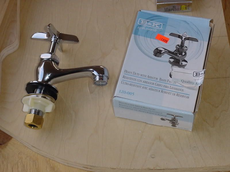

Hey Scott, this is what I bought.
You can find it here... http://doitbest.com/DoItBest/Main.aspx? ... SKU=448850
Mk
