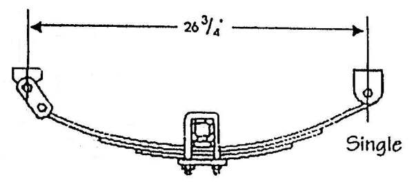

Postby Dale M. » Mon Apr 09, 2007 10:29 pm
Just my 2 cents also.... Front spring perch (forward) looks ok... Rear one is to far forward and holds the spring and shackle to flat (first pictures)... This is main source of bad ride...
Here is scan of spring setup that local trailer supplier gives out to people who buy parts and assembles their own axles and suspension...
It shows relationships of how thing should be when assembled... This sketch is actually from manufacturer of parts and dimension only relates to their springs.
Dale

Postby Miriam C. » Mon Apr 09, 2007 10:37 pm
Dale M. wrote:Just my 2 cents also.... Front spring perch (forward) looks ok... Rear on is to far forward and holds the spring and shackle to flat... This is main source of bad ride...
It shows relationships of how thing should be be when assembled...
Dale
Lynn's looks pretty close now to the diagram.
Postby Lynn Coleman » Mon Apr 09, 2007 10:39 pm
HI Miriam,
Thanks, I thought so too. I am curious about Gage's comments though.
Lynn

Postby Phil & Ningning » Mon Apr 09, 2007 10:56 pm
The geometry looks just fine now. Lightly loaded, it has sufficient travel for maximum potential compression. At full compression, the shackle will be just opposite of vertical from where it now rests.
Phil & Ningning
Posts: 103
Images: 65
Joined: Mon Aug 21, 2006 12:38 am
Location: Corona, CA
Postby asianflava » Mon Apr 09, 2007 11:42 pm
It may be an optical illusion due to the angle at which the picture was taken.
