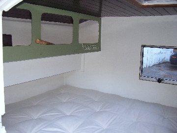

Day ..31.. Well she is weighed and registered! :D :applause:... I did not get to the garage to get the plug for my lights fixed. The guy that does that is on vacation. I did install a face on the inside cabinets. Tomorrow I am going to try and figure out where I want to put the battery and buy the fuses and buss bar. Maybe some cabinet work in the galley also. :thinking: Then again maybe I will just go camping? :thinking: :roll: 8) I don't really need power to camp after all I am use to ruffing it in a tent or a hammock while back packing! But the TV and a fan would be nice !......Oh yea I think I better go looking for foam for a bed also.....I promise I will get pics up as soon as I can for all of you that have bin following my build. :thumbsup:

Day..32.. Today I worked on the galley cabinets and put all of my camping gear in the galley. I went to the mattress store and ordered a Queen size 8" foam futon for $132.50. It will be here Friday... Tomorrow I could go to the bank for more $$$$$$ for a battery, fuses, and stuff wire up every thing and power her up. :thinking: Or I could go play!!!! :roll: :thinking: :D ...... I don't think I have enough tongue weight so I will have to put the battery up on the tongue. :thinking: Or I could wait and see if the mattress adds enough weight. :thinking: What to do !!! Decisions, Decisions?

Day...32.. I didn't do much today.... Painted the cabinet face in the inside green.... Cut out and painted a table for the outside.

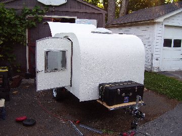

Postby kirkman » Fri Jul 20, 2007 9:55 pm
All done..Day..36..Not sure how many actual work days but she is done!!!! Bruce took picks today I will post them on Monday after I get back from camping. If any of you up state NY tear jerks are in the area I will be at Stony's camp ground in Pulaski NY this weekend. Kayaking and camping. :D

Postby kirkman » Mon Jul 23, 2007 3:49 pm
Pic's!!!! :thumbsup:
