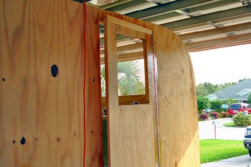

Postby Michele » Mon May 26, 2008 10:11 am

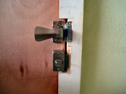

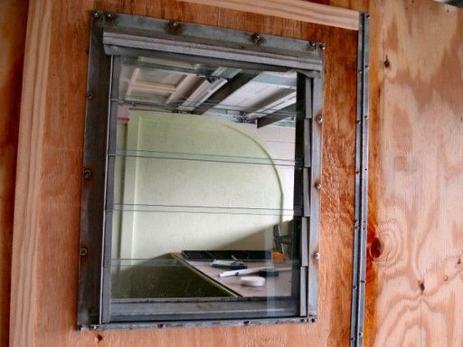

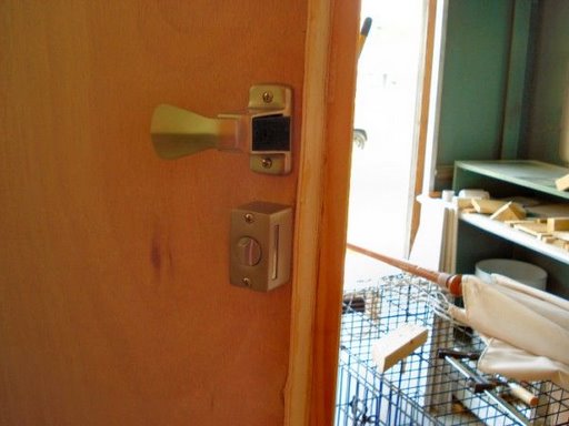

After an entire month of working on it, my door is finally attached. Also installed are the jalousie window from the junkyard and a storm door handle. I didn't put any T molding or any other type of metal trim on the door as I didn't want the added expense or the hassle of dealing with it.

Postby b.bodemer » Wed May 28, 2008 9:13 am
door, window and door handle look awesome...................I am enjoying watching all your progress and hope to build a standie at some point.
:thumbsup: :thumbsup: :thumbsup:

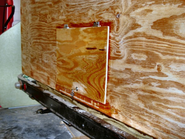

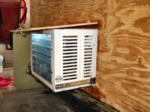

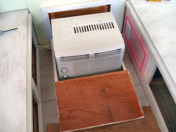

Michele wrote:The AC will not be permanately attached so that it can be pushed inside the trailer while traveling. Like others have done, I will be putting a small door on the outside for travel mode. If anyone that has done this has any helpful tips, I would appreciate the advice
I would design it so that the door that folds up and closes the hole in the 'travel mode' is also the shelf the A/C sits on when it's in use
That way you won't need the 2 X 10 permanently mounted to the bumper to bang your shins on as you walk around the back of the trailer
Use some of your piano hinge on the bottom of the door and weatherstrip it so it's waterproof when it's closed. It can rest on the bumper when it's opened and that will support the A/C

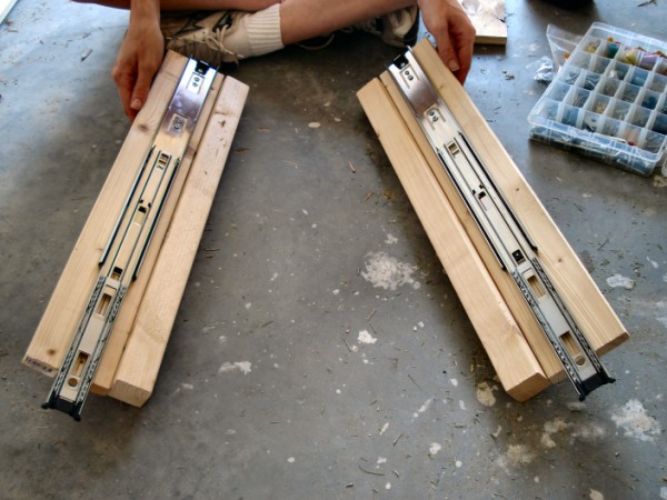

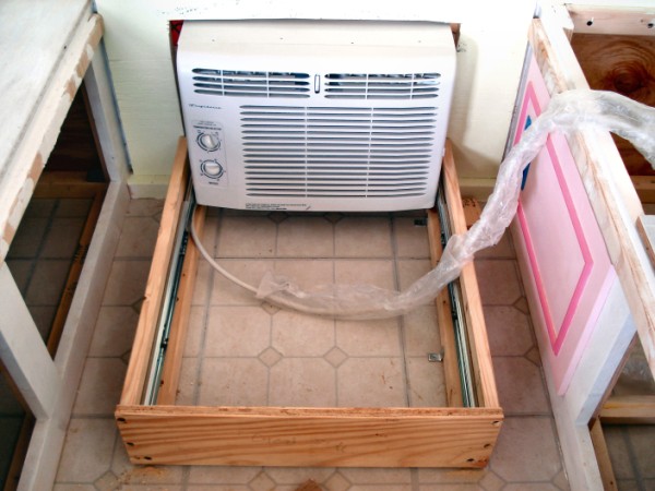

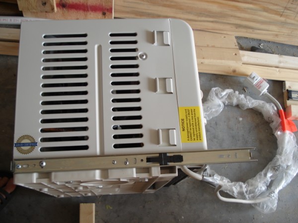

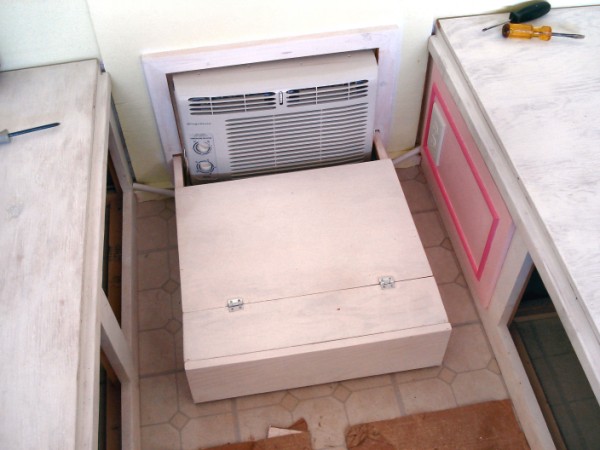

Postby Michele » Wed Jun 04, 2008 9:58 pm
I finally got my air conditioner installed the way I wanted it thanks to these pictures posted by Mike http://www.mikenchell.com/TAB_Photo_Album/index2.html
I pretty much copied everything he did except I added a little cover/door over the top of the drawer slide on the inside to help keep dirt and dog hair out of the slide rails. I think the pictures are a little confusing so I put a video of it in action on my blog (link in my signature at the bottom)

Postby mikeschn » Thu Jun 05, 2008 5:35 am
Good implementation of that slide out air conditioner! ;)

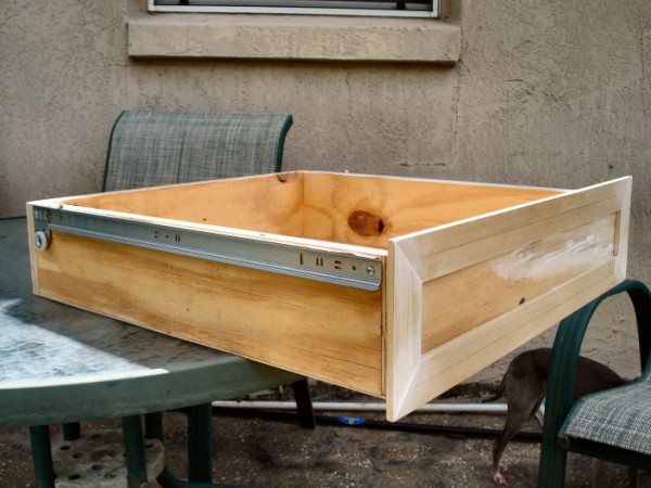

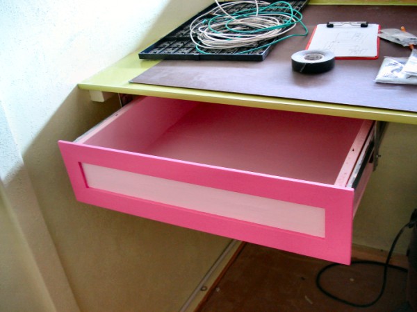

Postby Michele » Mon Jun 30, 2008 7:06 pm

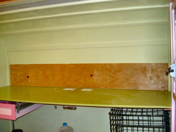

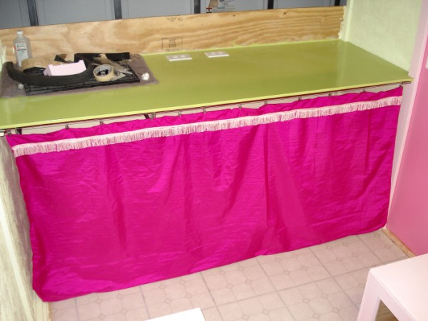

I couldn't put any cabinets under the counter top because of the dog crates. So I made a little drawer to go under there.
I also made a curtain that hangs under the counter top to hide the dog crates.
Michele

Postby b.bodemer » Tue Jul 01, 2008 9:04 am
Your dogs and you will be traveling in comfort and style! :applause:

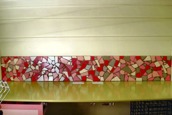

Postby Michele » Fri Jul 04, 2008 11:38 am

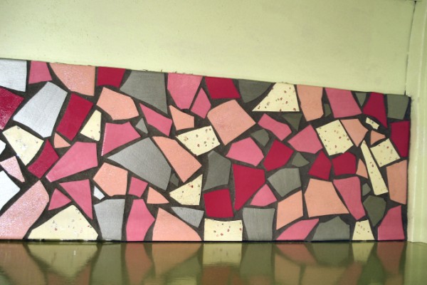

I tiled my backsplash with some left over floor tiles that I painted and busted up.
Michele

Postby Miriam C. » Fri Jul 04, 2008 9:42 pm
:applause: :applause: :applause: :applause:
Very nicely done Michele! I love the back splash. :thumbsup:
