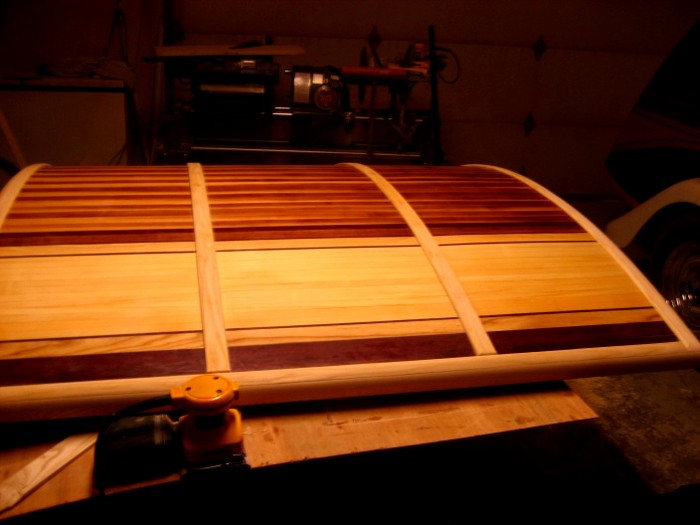

Back at it...after sanding the epoxy...I glued on the trim with epoxy, and have rounded over with a 1 1/2 inch hogzilla roundover bit. This treatment will carry over the roof. Pretty scary using a bit that size in a handheld router...one slip and trash...but it worked good and wasn't too hard to control. Next I'll wet down the trim, resand and start sealing the trim and final coats of epoxy on the hatch.

Postby Classic Finn » Sat Jul 12, 2008 3:32 pm
Beautiful... :applause: :applause: :applause: :applause: I,ll trade you tears anytime. :thumbsup: :thumbsup: :thumbsup:

Postby del » Mon Aug 18, 2008 12:45 am
Juneaudave wrote:Back at it...after sanding the epoxy...I glued on the trim with epoxy, and have rounded over with a 1 1/2 inch hogzilla roundover bit. This treatment will carry over the roof. Pretty scary using a bit that size in a handheld router...one slip and trash...but it worked good and wasn't too hard to control. Next I'll wet down the trim, resand and start sealing the trim and final coats of epoxy on the hatch.
I would have been sweeting bullets, but with the master it looks good.
