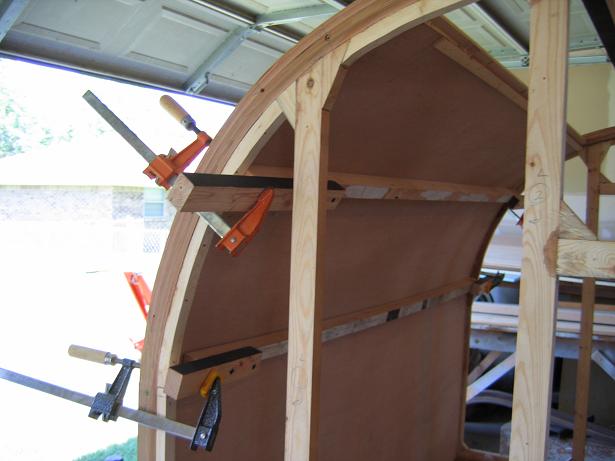

JasonTX wrote:I know this post is nearly a year old, but I just called this Boulter Plywood and was quoted a price of $34.00 a sheet for 1/8" plus $175 for shipping. I'm just curious as to how the shipping to Florida was $30 and now the big jump to $175. I also read that the owner took a trip to Vegas so maybe that'll explain the increase in shipping. I'll keep searching for another source.
When buying flexible plywood you need to specify the direction of the bend. For my build, I needed it to bend across the short, or 4-foot dimension, as I built a 5-foot wide tear. If you're building a 4-foot wide tear, you need it to bend across the long or 8-foot dimension.
If your ply bends across the 8-foot dimension, the sheets can be rolled up into a 4-foot long tube that can be shipped via UPS. If your ply bends across the 4-foot dimension, they'll roll it into an 8-foot long tube that must be shipped as oversize freight. Fortunately for me, I'm about an hour away (on a good day) from Boulter Plywood. So, shipping wasn't an issue for me.
asianflava wrote:I've also heard it called Wacky Wood, I guess it's the same thing.
No, bending birch and Wacky Wood are NOT the same thing. Bending birch is a multi-ply sheet with a birch veneer. Wacky Wood is a flexible 2-ply luan. On my build, I used Bending Birch on my interior roof skins and Wacky Wood on the exterior roof skins.

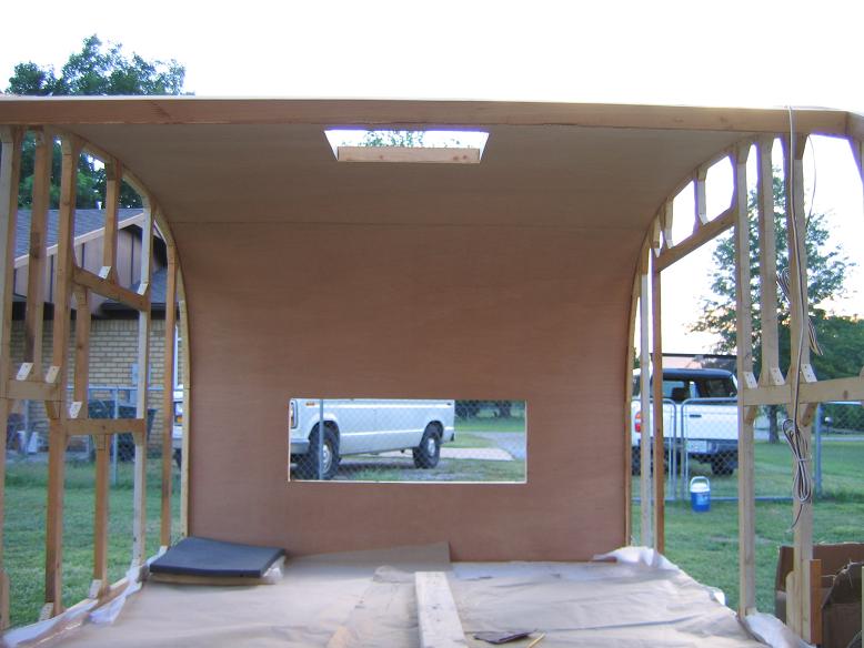

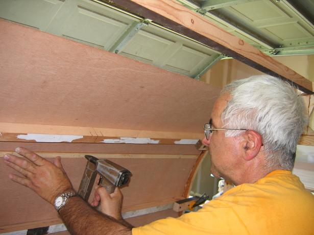

Postby jplock » Sat Jun 10, 2006 10:21 pm
Today I got my ceiling in using 1/8th inch luan mahogany. I found it at Sutherland Lumber for $7.99 a sheet. I will also cover the outside of my TD with two layers of this stuff covered by Aluminum. I had trouble with nailer driving nails all the way through the Luan. So I nailed through temporary sticks. This prevented nails going through the plywood. When finished I pulled the sticks off.
