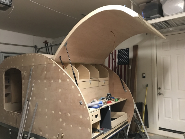

pmeyers wrote:The dimensions that I am working with are very similar to those of the hatch calculator. 48" hatch, 28 " strut and 12" stroke length. If the attachment point inside the galley is determined by the strut length as a radius from the hinge point then it would seem to be that when attached to the hatch it would not be long enough to even open the hatch. This would be made worse by the fact that the attachment point on the hatch is calculated on 85% of the stroke. My trailer is a Benroy shape and the hatch curves down at the hinge.
Take a look at the picture that is in the first post.
One end of the strut attaches to the side wall of the galley wall at a point from the hatch hinge point that is equal to the overall length of the of the strut. The other end of the strut attaches to the hatch at a point equal to 85% of the strut stroke length.
In your case the strut should be attached to the galley wall 28" from the hinge point of the hatch. The other end of the strut should be attached to the hatch 10.2" from the hinge point. The measurements should be taken in a straight line from the hinge point and not follow the curve of the hatch.
When the hatch is closed the strut will be compressed to length of approximately 17.8 inches. This compression force is what allows the hatch to open and stay open.
The overall clearance height that you will have with your hatch open depends mostly on your hatch design and the height of the hinge point from the ground level. If you desire more or less overall clearance height then you will need to adjust the recommended strut attachment points.
If you use the dimensions provided in the calculator spreadsheet the overall clearance height should be sufficient for most normal height people.

I made an account specifically to post here that the calculator worked for me!
My hatch is oversized at 68"L x 57.5"W and I built it with the intention of making it very strong (and therefore heavy at 74 pounds). I was quite worried about attaching the gas springs in the wrong place and putting holes in my siding where I don't want them. After reading a bunch, I finally settled on using Dan's excel sheet to perform the calculations and it couldn't have turned out better! Nothing like installing something the right way the first time. Thank you!

Jeepnick wrote:I made an account specifically to post here that the calculator worked for me!
Nick
Very glad to hear the spreadsheet worked for you/ :D

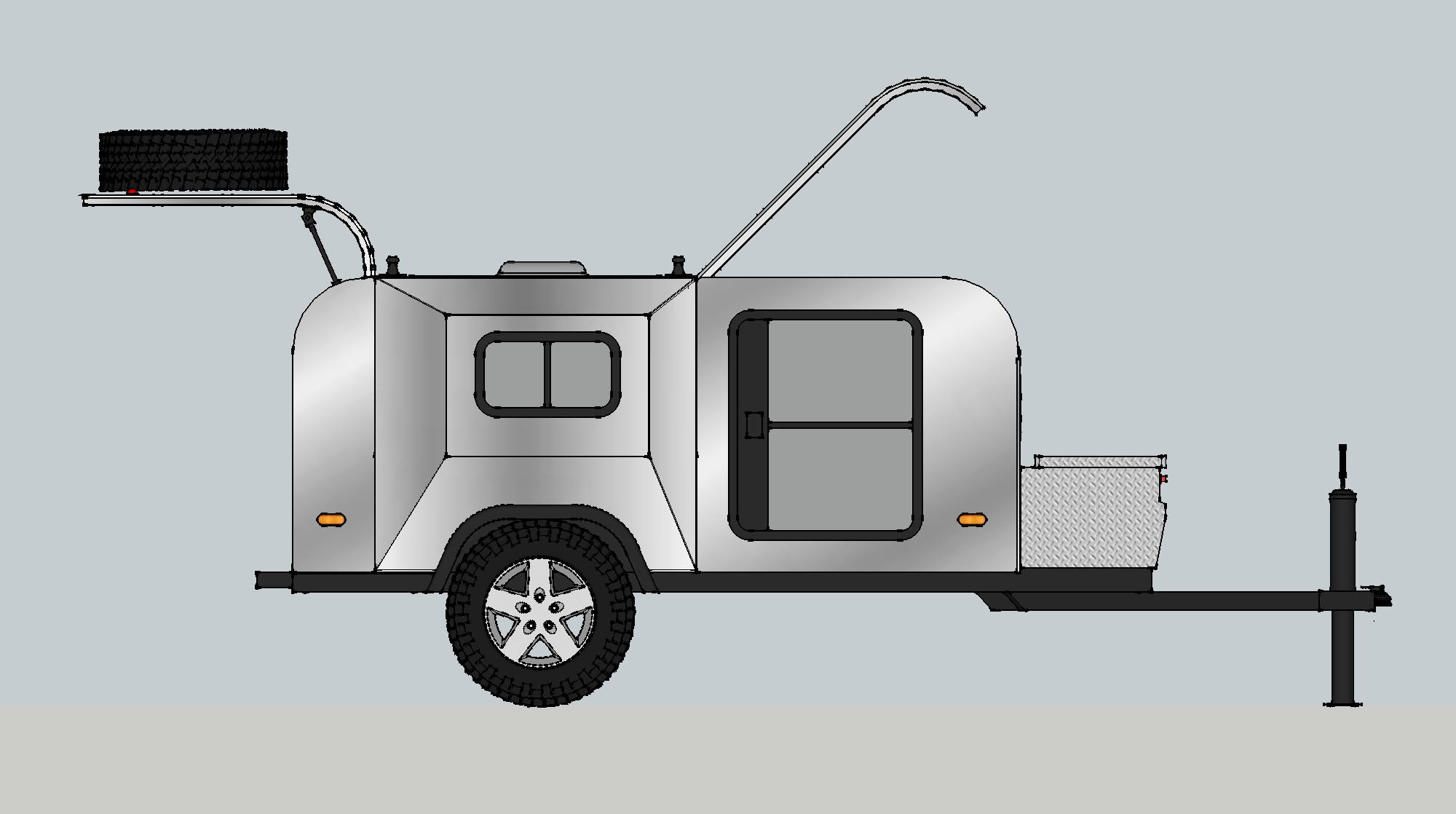

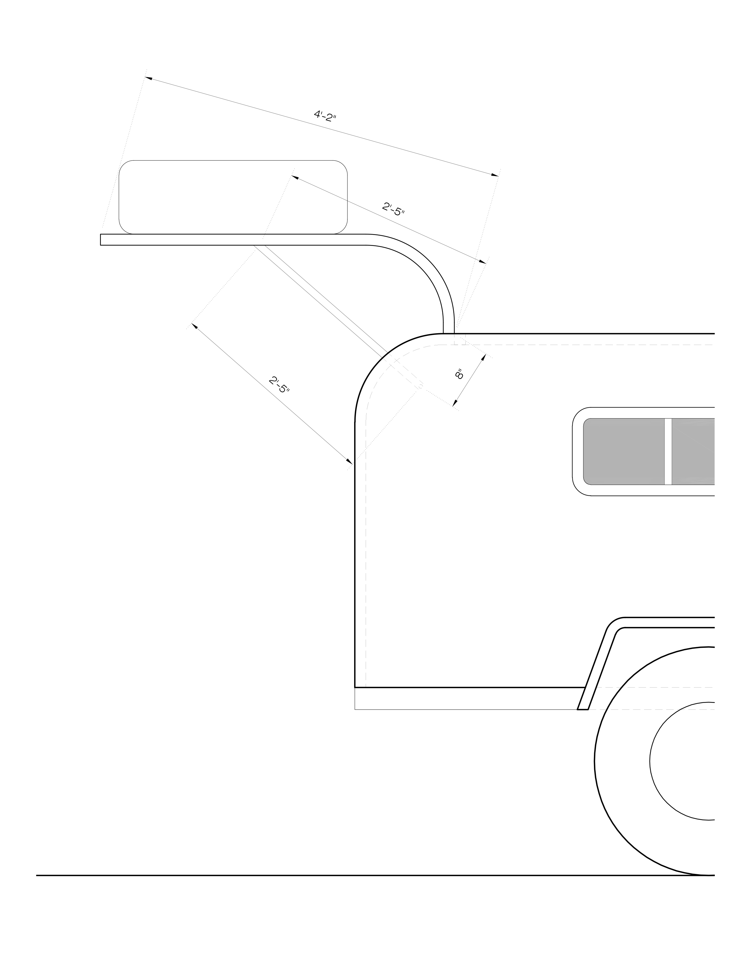

Postby bknowles86 » Mon Apr 29, 2019 12:07 pm
This is great and extremely helpful - thank you. I am in the final stages of design for my build and trying to get as many things figured out as possible before starting construction. I am planning on doing a rear hatch and front roof "hatch" per the attached drawing. I'm doing 1.5" thick insulated walls, so I'd like to ensure that I have wood backing/blocking in the proper locations ahead of time. I've estimated the rear hatch to be approximately 121 lbs TOTAL weight (will include a spare tire mount) and the front at approximately 69 lbs. TOTAL weight. My question is: is there a way to calculate the dead weight from total weight, per the configuration in the sketch? Thanks!

I'll chime in here since your post is sitting here unanswered ––but to cut to the chase, I think you're just going to have to build it and weigh it.
I like your profile but question the elephant in the room. The spare on the hatch.
I build Fredrick style hatches which are strong, and not overweight but I wouldn't want to hang a spare off of them. If I tried to build a hatch to support a spare, it'd probably be pushing eighty pounds without the spare. The heavier the hatch, the heavier the gas springs or course. Keep in mind, when the hatch is closed, there is a tremendous amount of pressure coming from those springs.
Spare tires are a problem. We carry a spare in our truck bed. With this new build I'm working on, I thought about looking for a donut spare in a wrecking yard with the right bolt pattern and include a lift on the chassis. That thought has come and gone.
I apologize for not being of much help, but I think folks aren't responding because of the elephant. :thinking:
:frightened:
p.s. And think about moving the door a bit closer to the rear. You want it even with your hips.

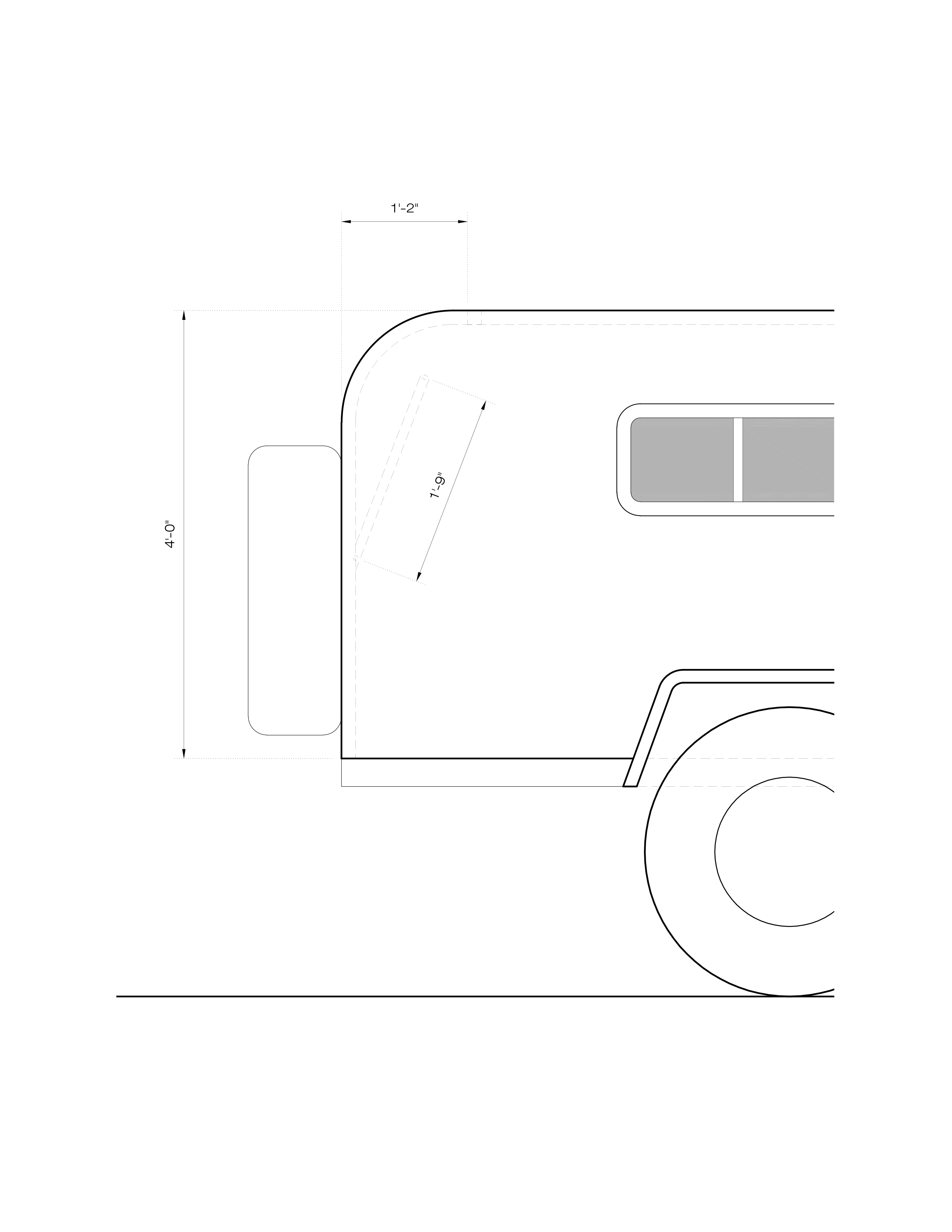

Postby bknowles86 » Tue Apr 30, 2019 11:00 am
Thanks Tony. I'm sure it's going to require a significant amount of force per strut to lift the spare, so I'm trying to configure the struts in a way that will be most efficient, using Dan's formula, but flipped in this case. (see attached images).

My plan is to build the hatch frame out of aluminum tube to give it the strength it needs without making it too heavy. My reasoning for having the door so far forward is to accommodate a twin bunk near the rear (we have a 5-year old daughter) which actually "pops out" of the sides a bit. I've attached an updated image.
Tear Drop Camper-profile.jpg (290.11 KiB) Viewed 7491 times
As per the struts, I suppose as long as I have a general idea of the attachment points I can make sure I have backing in place and then as suggested, weigh the hatch once it's built.

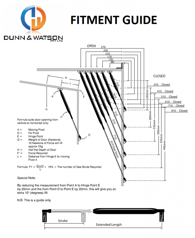

Postby bknowles86 » Tue Apr 30, 2019 11:03 am
I did find this sizing guide online - although it's in metric, it seems like it would work as long as the conversions are made correctly. Any thoughts?

Postby tony.latham » Tue Apr 30, 2019 12:02 pm
I suppose as long as I have a general idea of the attachment points...
Sounds good. I buy my struts at McMaster.com. They have detailed drawings of the struts plus a no-questions-asked return
policy.
