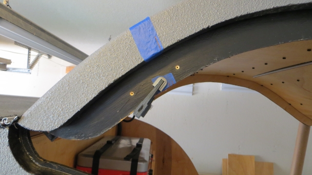

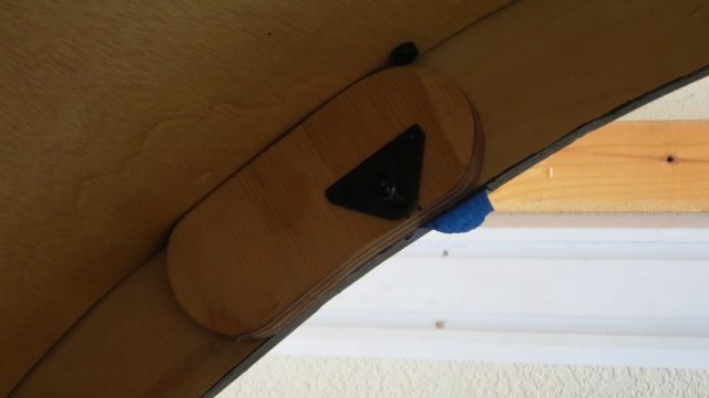

I decided the gas spring mounts needed some additional strength. I made some blocking out of 3/4" plywood.
I used a counter sink from the outside to secure them to the galley hatch gusset
I did add a few more screws than what I have pictured.

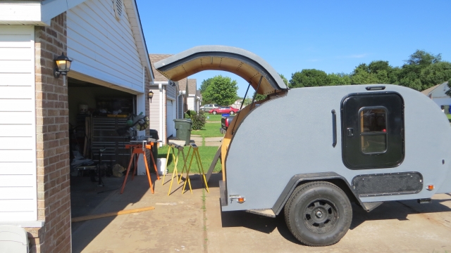

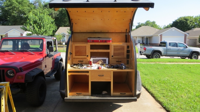

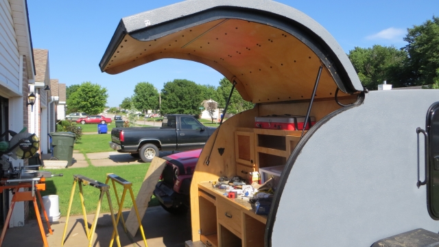

Got everything measured out and mounted. Opens and closes easily. The springs keep the hatch closed and I can feel a breaking point at about waist high when they take over and assist with the lift. Then shutting the hatch doesn't require much force.

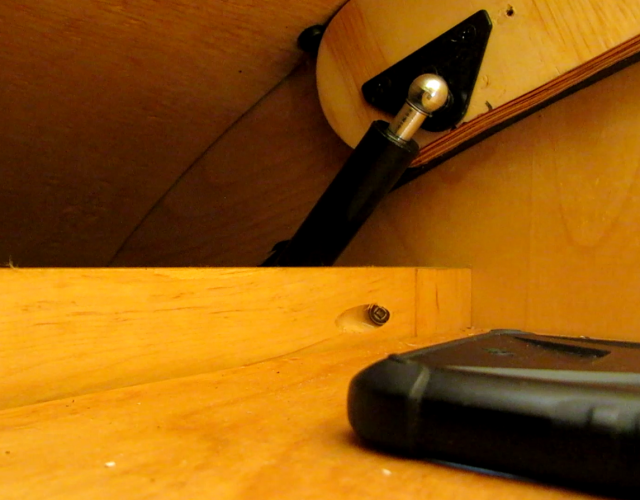

Last thing I did was make sure I had plenty of clearance on the inside for my cabinets when the hatch is closed. I put my camera inside and took a picture
I've gone so far as to take a video with the camera inside. :thumbsup:

Pulling down to close the hatch is a lot easier. It doesn't take near as much force to break them to close.
I can really tell the difference in opening. Before there really wasn't a breaking point at the waist. When I opened the hatch the springs kicked right in and opened it up. Also the springs don't open it as forceful. If I were to let go and allow the springs to go by themselves the hatch opens slower

I hope your solution works but I have had a little experience with this also. The top attach points are very close to the hinge point and bulk of the hatch weight is on the end of the hatch, like a lever and that will put a lot of strain on the hinge. I moved my top attach point back closer to the center of the hatch arc. This alleviated the stress on the hinge and attach point.
