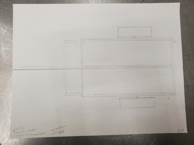

Postby ptulli » Mon Nov 01, 2021 8:07 pm
Hey guys, been a while it's been crazy around here and with prices up on everything this took a backseat to other stuff. I have been thinking and working on idea. This is my latest frame design. 5x8 and a 18" front storage spot that I'm gonna use for the electrical spot and additional storage. I am not sure on the spacing for the cross members and design of the tongue. I am going to run the main part of the tough all the way for a possible recovery. Any ideas? Am I on the right track? Thanks guys!
Tow Rig: 2016 Wrangler 2d, planning overlanding/off-road camper (squaredrop/squareback)

Postby JasenC » Thu Nov 04, 2021 12:30 am
Torsion bock construction is supper strong at a reduced weight.
It's a grid work of, for example, 2x2's with your plywood glued and screwed both side.
My portable work bench, made from scrap off the job site, is 24x60" made of 1.25" ribs on a roughly 12" grid layout, skinned with 1/4" on the bottom and 3/8" on the top. nearly 0 defalcation with me bouncing on it at 175 lbs.
6 coats of clear finish and it has been caught in many rain storms in the back of my truck and it is still flat as a, wait for it..
board.

Postby ptulli » Mon Nov 08, 2021 8:10 pm
Sorry I meant by the cross members on the trailer it self. The torsion construction you mentioned for the flooring it how I plan on building that part. I am trying to figure out how best to design the trailer for now, then work on the box after that. I would like to put a water tank under the floor and a spot for possible storage as well. Nothing too deep but enough to put the RVQ in it and water. I will put skids on it for I will be off-roading with it, so gotta keep it protected.
