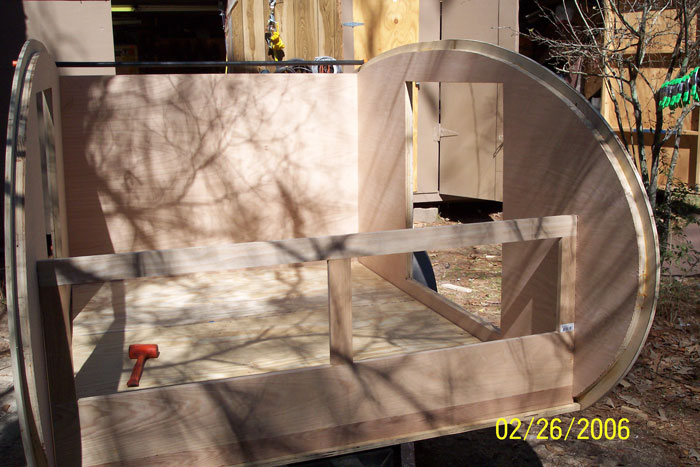

Postby asianflava » Fri Jun 30, 2006 3:15 pm
The sidewalls are made from 4X8X1/8 luan, the seam is along the hinge line of the door.
It is obvious in this pic:
The reason I put it there because the framing is thick there and it runs from top to bottom. Everything else except for the top roof skin is 5X5X1/8 baltic birch.
This is how I attached the roof to the walls. It looks like there is no mechanical attachment between the top skin and the wall but actually the aluminum trim has screws that go thru.
