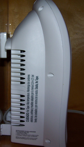

Postby Psychohillbilly » Sun Oct 29, 2006 9:22 am
Doug,
This is what I bought. It has a bult in thermostat (60 to 80 deg) Wall mountable (removable for the warm season) and cost less than 20 bucks at Wallmart or Lowes. I plan to hang it from my cabnet door.
:peace: Chuck

Postby halfdome, Danny » Sun Oct 29, 2006 11:07 am
Psychohillbilly wrote:Doug,
:peace: Chuck
That looks safer since it can be mounted on a wall. I tried out a small ceramic heater & I noticed that even on a 750 watt setting it can get the ceiling of my tear really hot. I wish there was something with less power or had a variable heat setting below 750 watts. My tear is only 12 volt but it wouldn't be that hard to add one circuit of 110 volt. I'll see if our Walmart or Lowes carries that model. :) Danny
