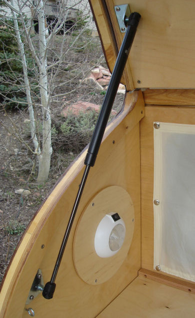

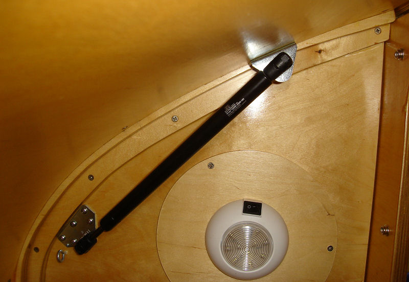

Postby jmtk » Wed Jul 09, 2008 9:31 am
Heikki,
Here are a couple more pics for you to ponder. I used Sonetpro's installation as the basis for how to put mine in. Here's the diagram he made that I used: http://www.mikenchell.com/forums/viewtopic.php?p=121099&highlight=struts#121099
Don't give up on the gas struts yet. They work great! Once you get it right you'll be glad you persevered. It just takes a gentle tug to get the hatch to start opening and then the struts do the rest and magically push it fully open. Camping with a young child, I also like the safety factor. I don't have to worry about props getting knocked out by strong wind gusts lifting the hatch or people bumping them.
Jeanette

Postby tonyj » Wed Jul 09, 2008 10:26 am
Tripmaker wrote:Looks like you need to reverse your mounting points. Mount the lower end, attached to the galley walls closer to the hinge, and the mount attached to the hatch further from the hinge. I used starwheel supports so lifting it is by the armstrong method. But with gas struts this configuration requires less effort to lift the hatch.
When you close the hatch the support rotates downward. Mounted vertically like you have it you are limited to lowering the hatch to the closed length of the cylinder.
This is one of those areas that generates two opinions on mounting, as well as rod up or rod down. Both mounting positions work (as well as rod up, rod down).
