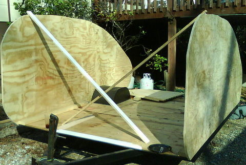

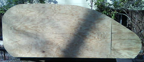

Postby nevadatear » Sun Mar 29, 2009 9:32 am
MsDana wrote: 8)
I Have pictures!!!! I test fitted my new sides yesterday. They still need sanding..stain and poly...Oh and I have to make a door and some windows.. :wine:
Ta Dah
http://tnttt.com/album_ ... c_id=48090
http://tnttt.com/album_ ... c_id=48091

Postby MsDana » Sun Mar 29, 2009 4:29 pm
Hello Nevada Tear!! I like your style 8) Im not sure what you call it but I really liked the cub and the slumber coach(i think) :R But ne way I just drew it out wit some string an a pencil. :o
Thank You!
