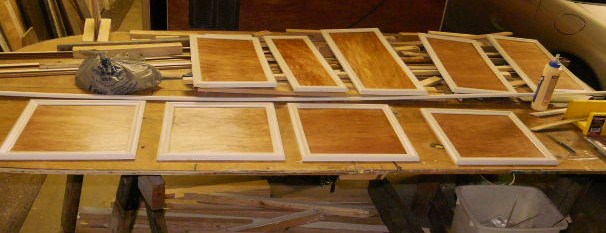

More work on the galley doors. The exceptional hot and humid weather continued all this past week too, really taxing my desire to continue with a project with real problems. However, the panels and frames are at least together. Yes, the brads went through to the work table, but let the glue dry with the panels staying flat without my concrete block gravity clamps scraping them up. I used left-over bits of luan but too late realized that the hinge screws would stick through the front, so got inset hinges and glued 3/8" scraps under them. The close-up flash photo of the mock-up of that did not come out and will have to wait for daylight.

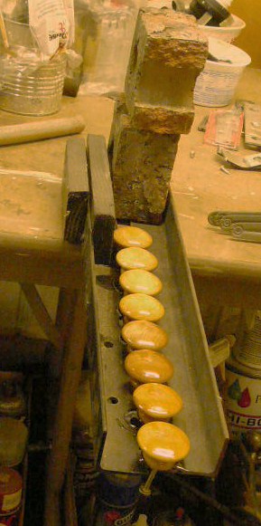

The knobs are the cheapest wood jobs, mounted on their screws and dipped in polyurethane. I'm pleased with the thrown-together drying rack, two bits of angle, one already made into a mount for an electric trolling motor for a long-gone sailboat, counterbalanced with half-bricks.
Like so much that I've done on the TTT, this was all new to me, so the first ones were terrible and the last ones not so bad, so I made the far bottom ones first and the eye-level ones last, just as I made the back wall first and the curb side last.

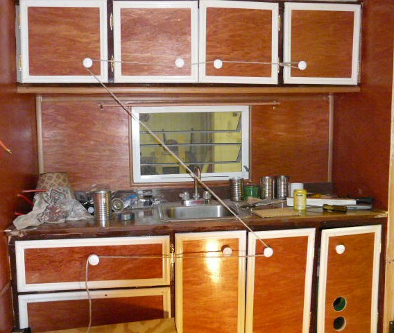

Galley doors finally built, adjusted, hinged, fiddled with, knobbed, adjusted, urethaned, fiddled with, hung, and adjusted again!! The string is because the catches are not done yet and I wanted to skip gouging myself on one while working on the next. If there is another time, I'll have them made or at least do solid doors. I thought framing the walls was tedious! Obviously I did the knobs over, white after all, dipped and dried the same way.
The stain proved to be the color of clay mud, I suspect mineral spirits used for brush cleaning, then poured into an old stain can for disposal! I went with some dark brown paint I had around and kind of like it.
We caught a couple of fine days and all the new wood is brought up to two coats of urethane. Having the garage door open at last for that attracted four neighbors for twenty-five cent tours, all free. Kinda' fun being a mini-celebrity.

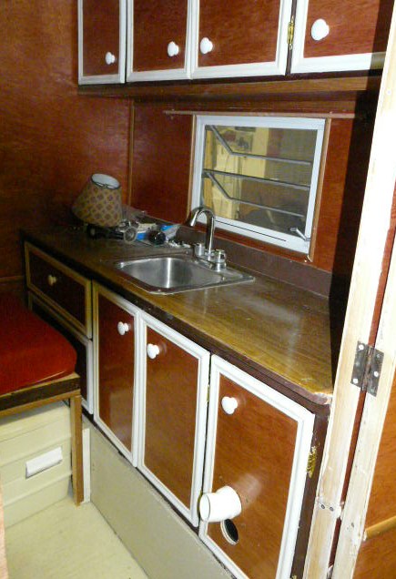

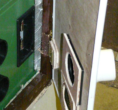

I'm kinda' proud of this little fix that lets the cabinet door swing open without a huge oval hole for my angled fitting on the A/C outlet. It's the plastic piece meant for the doghouse end of one hose, sawed short, mounted through the door and shimmed up, with my fitting wedged on the outside, to swing open with the door. It and the lower vent, just shimmed, fit snug against the A/C ports. Incidentally, the outside louvers have screens and bits of fine mesh are on the interior vents.
You can see the shimming I had to do under the hinges because of using framed luan for the doors. Hey, I taught myself all that as I went along, and my teacher knew only as much as I did! With a little time left after touching up the paint but not enough to start something else, I finally cleaned up the tools and scraps in the trailer (mostly) and garage and swept up, so had to retire from the most out-of-control shop competition! I get rolling on something and soon it's back to turning around and around in place, rooting under piles of this and that, and muttering, "Dammit, it was right HERE a minute ago!" Aww.

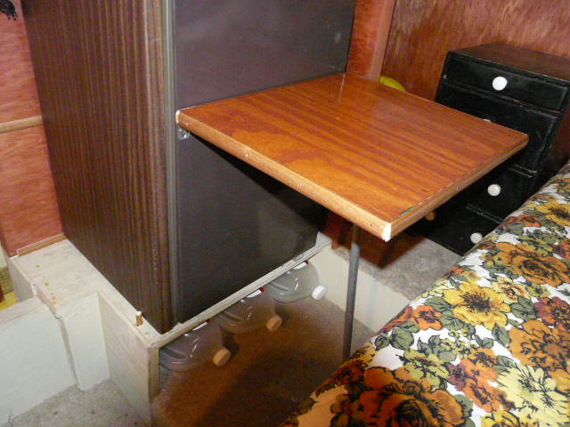

Better this week, two good days. Tuesday I got the carpet installed. Thursday before being called away I got one drawer knob repainted [sigh] and later started hooking up the tongue wiring but ran out of steam, not one of the good days. Today I got the fold-down table installed on the side of the fridge though I want to touch up the trim. The prop fits over a stud, so the table won't collapse if I bump it or the prop. All week in odd moments I got, uh, odd bits done. Those are the drinking water bottles I mentioned under the fridge.
