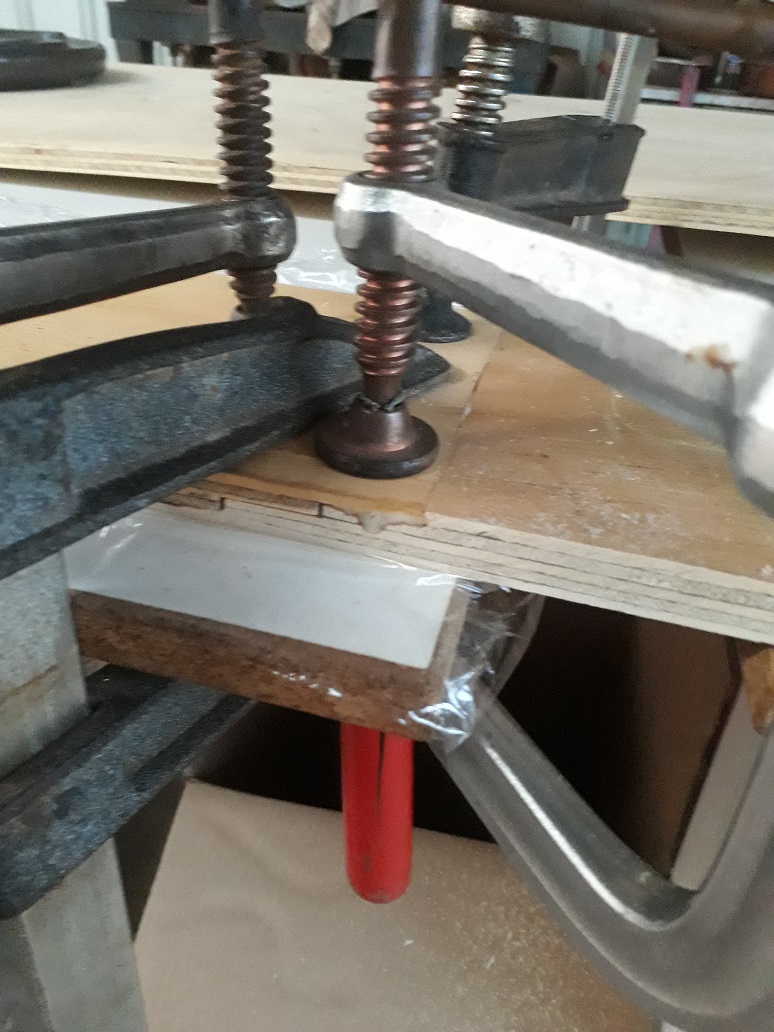

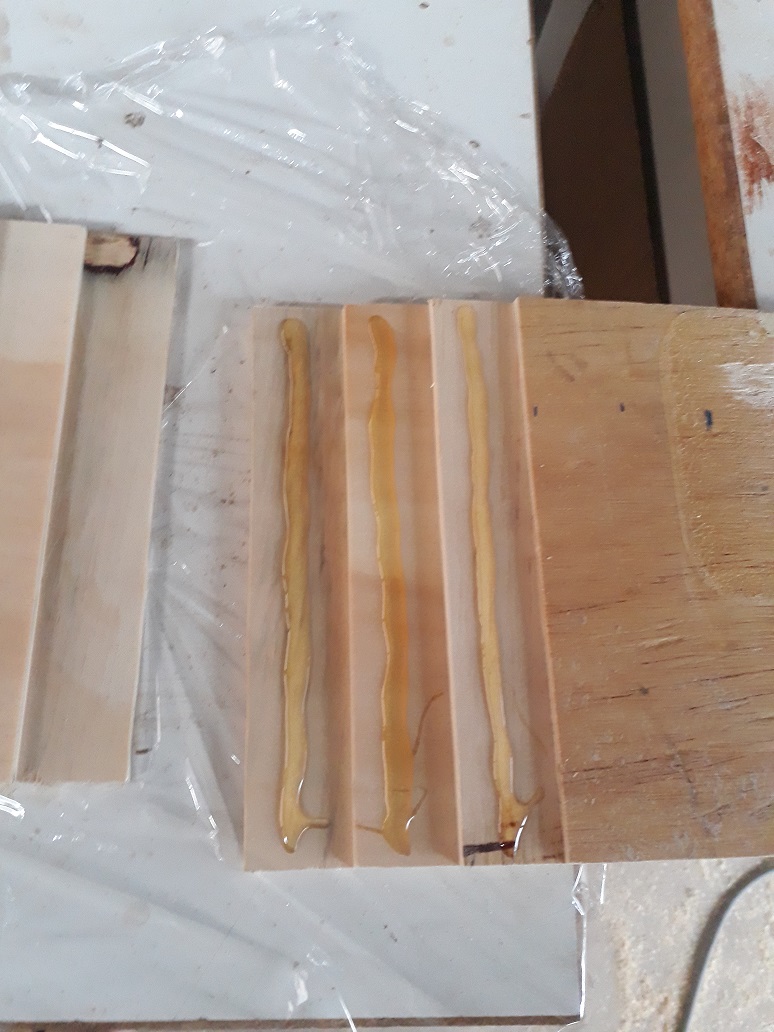

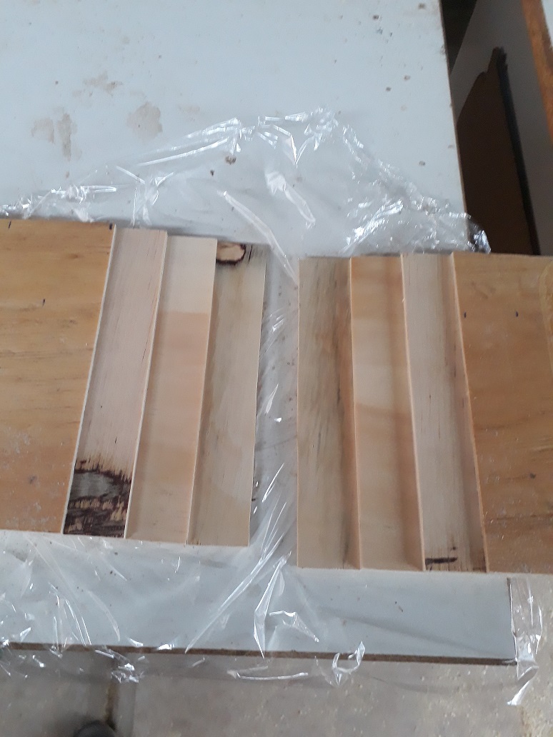

Not wanting to build a scarfing jig, nor spend time learning to finger joint ply, I decided to take an off-cut and see if a "triple lap joint" would do the deed.
I chucked a cutter in the router and set to work.
I cut laps at 3/4, 1/2, and 1/4 the thickness of the ply, cut the piece in half and tried out a glued triple lap.
I'll see tomorrow after the glue has set whether it is a viable solution.
I might go a bit wider and increase the overlap when I do it for real.

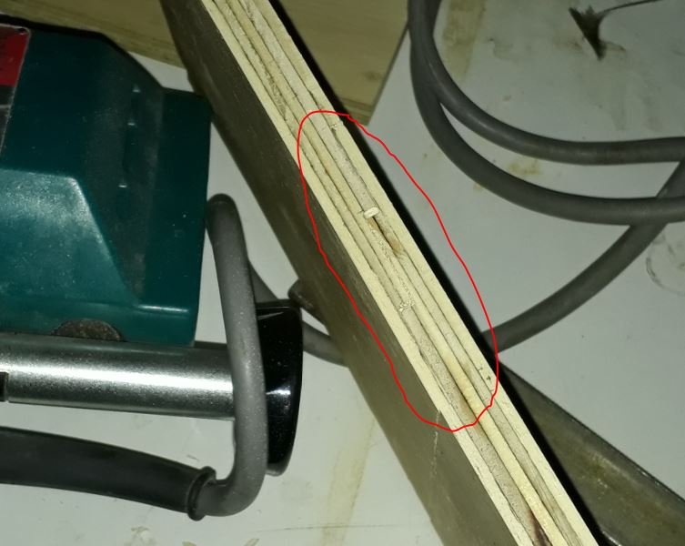

It has been a battle getting a decent photo.
I machined a single piece of ply then cut it in half to get two pieces to join, so the plys don't line up because the layers of veneer are different thicknesses.
Maybe I could have tried a little harder to get the right depth of cut, but I'm quite happy with the end result, and it was very quick and simple to do.
I'm very surprised at the strength of the joint.
I think this is the technique I will use to make my 8 feet sheets into 9 footers.
