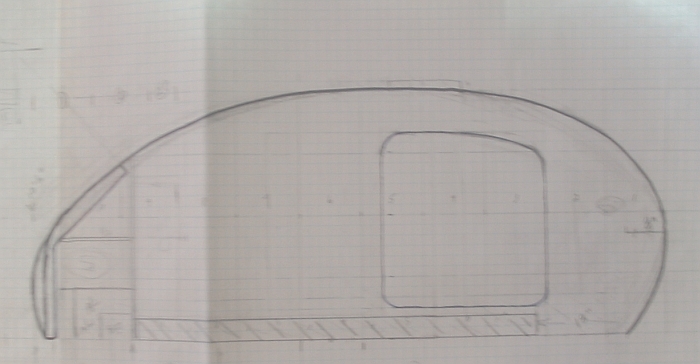

Postby Arne » Sat Apr 01, 2006 7:15 am
I finally made a decision. I'm going to make a semi-frameless tear. I bought an 1800# h/f trailer (using the 20% off coupon). The tongue will be V shaped. Each leg of the V will be made of 2 - 4' h/f outside rails welded end to end, with an 8 inch piece of x-member welded inside to overlap the joint where the 2 4' pieces meet. Those outside rail pieces are pretty sturdy and will give me the equivalent of a 3" x 3" tongue, 1/8" thick. The V will give me a lot more stability for attaching to the floor (no perimeter frame), and a place to mount a tongue box. Unfortunately, I'll go with 3/4 ply instead of my 1/2 ply.. I just think the extra strength of 3/4 is needed ... the extra 50# isn't.
The suspension will be mounted on stub frames 4 feet long on each side. I figure this design should save me 100# and be quite strong.....

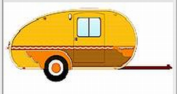

Postby Arne » Fri Feb 02, 2007 4:46 pm
I've been thinking about spud... and I saw this pic and it clicked.. I think i'll borrow this shape, or one close to it....

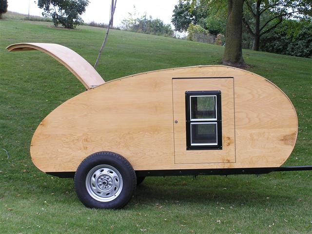

Postby Arne » Fri Feb 02, 2007 4:50 pm
Or like this, but the rear tuck under will be small because of the way I will build the hatch.

Postby Arne » Tue Feb 06, 2007 12:12 pm
The design has been finalized and approved by you-know-who... I will be starting construction in march, and be ordering parts soon.. hope to have it done for trip to Bluegrass Classic sheep dog trial in mid May..
the slope on the back will be slightly more flat than this design, but very close.

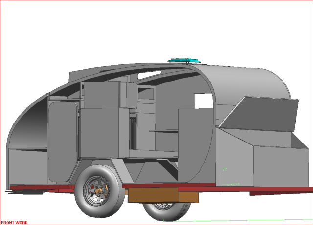

Postby mikeschn » Wed Feb 07, 2007 5:21 am
Complexity? Yea I can relate... check this out. Notice the windows in the trollytop? the Air conditioner? The swivel TV? The compound angles in the tongue box? Oh, lets not forget a place for all the show dogs! :o :lol:
