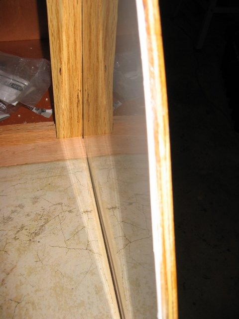

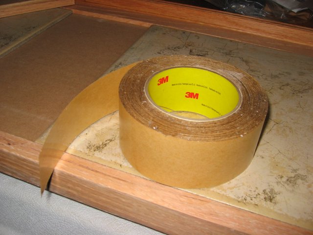

Hey Sid - That galley is looking great. :beautiful: :applause: Tell me more about that 3M double sided tape. I have not found anymore of the Henry's up here but somebody has to have it. I will keep looking.
Is that double sided tape some special kind? What type store does one find it at. Does it come in a roll, or is it in those little short strips?

....try an auto body/paint supply house if ya can't find any at the bos or hardware stores...it is also used to apply auto body trim

Ron, It comes in a roll, 2 inches wide. Actually we were doing a helicopter modification on some litters for a medevac bird at work and had a little left over, so I thought I'd give it a try. All I can tell you is it's made by 3M. It has no part nnumber or anything else on the roll, just 3M.
I posted in an earlier post that Farmtek has an industrial strength doublesided tape, and I would imagine it would work. I listed the part number and it was $5.95 for a 25 yard roll.
I was pretty impressed because when you get it put on, it actually just looks like another layer of the plywood.

I believe that 3-M calls it VHB tape. Very High Bond. My company has used it for years to apply exterior grilles on the outside of windows.
We have had excellent results with its adhesive qualities.

Here's the info on the tape I am used. Found the MWO this morning and looked up the part number. It's 3M part # 950-2
Here's the info from Hillas Packaging, Inc.
Item Number : 3M 950 2 X 60
Description: 3M Adhesive Transfer Tape 950, 2 in x 60 yd, 24 Per Case
Unit of Measure : RL
Qty Per Package : 24
Weight Per Unit : 1.56
Additional Information :
Use for automotive under hood label bonding, attaching gaskets and variety of industrial foam materials, and foam lamination to various surfaces.
Vendor Detailed Description :
5.0 mil, high strength 300 adhesive with 3.7 mil, 60 lb densified kraft paper liner. High tack, good adhesion to LSE plastics and foams. Medium temperature and solvent resistance, high HSE and LSE. Thicker version of 927.
UPC Number :
00021200048517
Vendor Brief Description :
3M™ Adhesive Transfer Tape 950, 2 in x 60 yd, 24 per case
Vendor ID Number :
70-0060-3057-4
Additional Product Documents :
http://www.hillas.com/Froogle.asp?Item=6050
If you go to this web site you can look at the MSDS also.

:wink: We are so grateful you posted the tape and the polymax It looks real good on the inside too. Might be that this is an alternative for folks who want a light weight 5x10 skin to cover the seams, screws and oops. I have a hundred questions but I think I will wait for you to do the skin and see if they are answered. ;)

I know we covered translucency before, but would a colored underlay show thru, like bright green or orange, that would make it look tinted, also have you tried edgelighting it, does it transfer light thru the panel if the light is placed at its edge?

gman, it's much more dense than that. Any color laid behind it would not show any color through it, it would only block what little light might be coming through. It would not show as tinted.
As for the lights, maybe a faint glow would show through, but doubtful, and definitely no usable light.

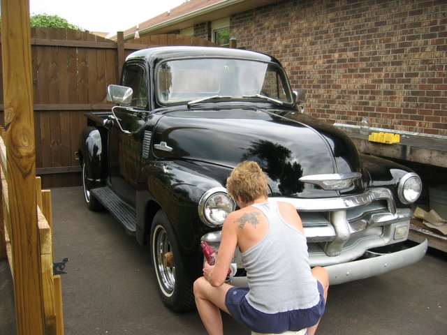

Is that a first half 55 chevy?

You are correct.
1955 First Series. Last year they made that body style and they changed to the newer body style in mid year.
By the way.... IT IS FOR SALE.... It actually belongs to the wife.
$5,000, but I bet she'd be negotiable.

Good price, I have a 56, all Camero underneath, just needs painted. Its buried under boxes in the garage right now, waiting for the spring thaw :lol:
