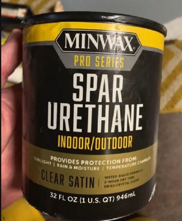

Will this work for “The Mix”.
I have some of this on hand and some mineral spirits so wondering if this will work. I mixed some up in a paint tray but it doesn’t seem to mix very well together. The MinnWax sinks to the bottom and the Mineral spirits just floats on top of it so I’m not sure
If these are ok to use as “The Mix”
Also I pulled out my gripper paint and a bed sheet to try out and see how it looks on some plywood and see how good it adheres. I’ll check it tomorrow but it may take longer to dry since it’s in the 40’s out today.
Sent from my iPhone using Tapatalk Pro

lacofdfireman wrote:...Will this work for “The Mix”.
reduced-size image
If these are ok to use as “The Mix”....
Not really. Water and oil don't mix (or water-based and oil-based), IMHO. I did some testing of the "mix", with my chosen polyurethane (Minwax Fast-Drying Semi-Gloss) on small pieces of scrap plywood, before the actual coating day came for the exterior shell. I hadn't used the "mix" when installing my two-part floor - 1/2" birch ply coated completely on top with Tite Bond 2, and with 1/4" Luan glued (and perimeter-screwed) to it, laying all on top of frame and cross-members. The luan top was triple coated with pure poly, since it was to be inside, away from rain and UV, and completely covered by rubber/carpet floor matting, while the underside was sealed with many coats of spray-on automotive undercoating. The exposed perimeter edges of the floor were still raw, but would be sealed along with the cabin shell, with "mix" and paint, later.

So,I hope I didn’t screwup my new sides now since I ended up using some of this MinnWax Urethane mixed with Mineral spirits at a ratio of around 25% MinnWax to 75% Mineral spirits. Think I screwed up my new sides? I figure the mineral spirits will most likely just evaporate off.
So I guess I need to figure out what I’m doing here with “The Mix” Any Chance someone could actually screen shot what I should be using?
Is this the right stuff?

Yep, it is oil-based. same basic chemistry as the Minwax I used, but with UV protection (mine didn't need any, as it was to be painted over). I used the Spar poly you show, as a coating on a walking stick, and also on a shillelagh/cane, that I made two years ago (for the day coming soon, that I'll need help walking). The cane is exposed to UV year-round, sitting on the gun rack in my truck's window, and I've left the walking stick outside my garage, in all weather, for a year now...no adverse effects there, either.

working on it wrote:Yep, it is oil-based. same basic chemistry as the Minwax I used, but with UV protection (mine didn't need any, as it was to be painted over). I used the Spar poly you show, as a coating on a walking stick, and also on a shillelagh/cane, that I made two years ago (for the day coming soon, that I'll need help walking). The cane is exposed to UV year-round, sitting on the gun rack in my truck's window, and I've left the walking stick outside my garage, in all weather, for a year now...no adverse effects there, either.
So what are your thoughts on me using the water based MinnWax that I had laying around with the mineral spirits? Can I just go right over it with this PolyUrethane and Mineral spirits? I’d imagine I can.
