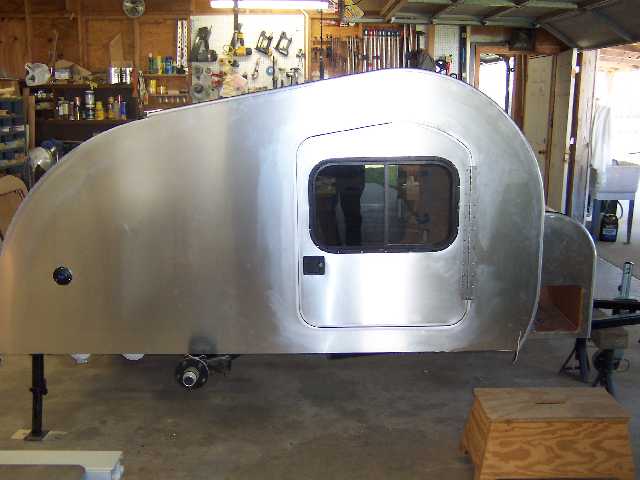

Postby madjack » Mon Mar 20, 2006 11:04 pm
GPW wrote:Guys , I got my windows off E-bay from a Frank Bear in Pa. They're nice Hehr windows , but I haven't a clue how to mount them .... they came with no mounting rings , so I'm stumped .... do I drill holes in the frame and screw them to the outside or what ...??? I dunno '
..we used a similar window and it came with clamp rigs...didn't like 'em so we drilled thru the frame, buttered it up with butyl rubber sealant and screwed 'em on...pics tomorrow
madjack 8)

Postby GPW » Tue Mar 21, 2006 7:53 am
MadJack ... Thanks Dude , That works for me !!!!! :) Is there any issue with using steel screws in an aluminum frame ,over time ....should I use SS screws?

Postby madjack » Tue Mar 21, 2006 8:50 pm
G, we used SS fastners for anything exposed to the weather...a steel screw will leave a rust stain on our pretty AL...as far as galvanic corrosion, as much sealant as we applied to everything there is no real metal to metal contact...and hey Mullet, I am glad you finally got going here...welcome aboard

Postby GPW » Wed Mar 22, 2006 7:55 am
M/Jack .... WOW!!! That looks GREAT !!!! Love those pics ... Now I know what I have to do ...

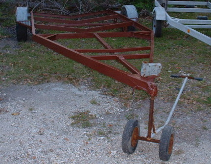

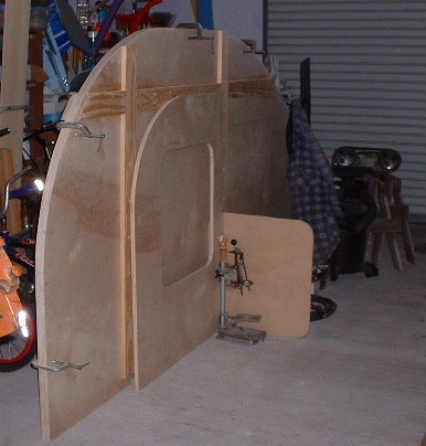

Postby GPW » Sun Mar 26, 2006 1:59 pm
Trailer's all in Prime now , looks so much nicer ...Glad that's done !!! a friend came by to help me (I think he wants one too ) Got the floor ply (3 pieces of 4'x6' cut out .... fitted the floor frame to the trailer ... Perfect fit(TG)!! got the sides clamped together and belt sanded them even ... moving along now ... :)

Postby GPW » Wed Mar 29, 2006 7:25 pm
I know Mad Jack likes to see pictures ...Image
The trailer in prime ,welding next
the sides sanded even
the floor frame and sheeting parts

Progress #1 Took the welder(retired) to the store to get a 4 prong #8 dryer cord ...he says we can mate it to the 3 prong extension on my Lincoln 225... I dunno ??? But if this welding thing doesn't happen soon , I'm going to borrow another friends MIG suitcase and weld it myself ... holding up the whole job now ... Today I'm starting the floor / frame assembly ... screws and LHDCA, then the poly and roofing cement on the bottom ...

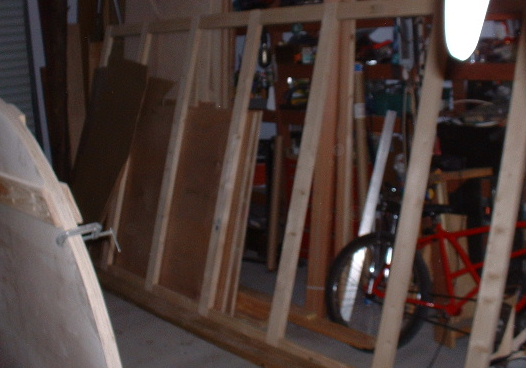

Postby Ira » Fri Mar 31, 2006 8:33 am
Wow. That tongue looks LONG. (Maybe it's just the picture.) What are your final dimensions going to be again?
And another question:
Why do I see 2-by lumber on BOTH sides of that wall? I understand for the interior, for insulation, wiring, etc., but on the other side too? I don't get it. Is it just decorative?

Postby GregB » Fri Mar 31, 2006 2:55 pm
Ira,
I'm guessing that is two walls, back to back.

Postby Ira » Fri Mar 31, 2006 3:02 pm
GregB wrote:Ira,
GB
Duhhhhh....
I TOLD you I was getting old in another post!
Good thing I also didn't ask why that wall looked like an inch and a half THICK!
Man, do I feel dumb and have egg on my face!!!!
