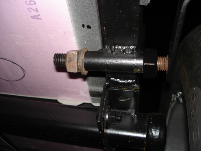

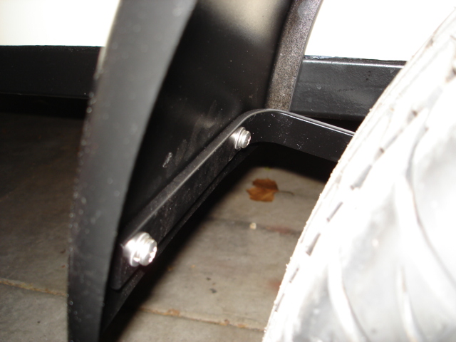

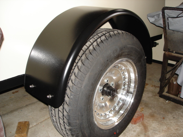

Well, got the fenders on today.. found a perfect rubber gasket to put between the fenders and TD at Advance Auto; and my "custom mounts" seemed to work great.. they allow full mobility in and out for different tire widths, etc... and they're completely removable w/ two nuts in case they get damaged with a blow out or something... just leaving myself room for "upgrades" in the future..... oh..the four bolts holding the fender to the mounts are stainless steel w/ "castle nuts" on the outside.. thought it might help to add alittle bling. They kinda look high, but according to Dexter they had to be 14.5" above the bottom rail of the frame... so I guess I have plenty of POTHOLE bounce clearance :lol:
She's coming together....

Postby Podunkfla » Tue Apr 24, 2007 8:28 pm
Keith... Very neat way of mounting your fenders... I like it. :thumbsup:

Postby Keith B » Tue Apr 24, 2007 8:48 pm
Thanks, and well, I have to give credit where credit is due.. I copied it from bledsoe3, but instead of just welding them directly to the frame I added the "all thread/slip pipe/nuts and washers" for adjustments/removal/repair, etc. If you need more pics or anything just ask.... the only "addition" I'm going to add is vinyl lettering on them... "No Sit / No Step" :lol:
