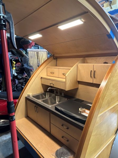

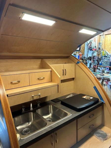

When I install the strut using the measurements in the calculator, I will have to compress the strut about 4" to mount it. Does that sound correct? Do I raise the hatch higher in order to attach the strut when it is fully extended? Is there an easy way to compress the spring to install them?
Overall hatch length is 56.25,
Extended length of spring is 32.25
Stroke is 12.5
Hatch Dead Weight is 58 lbs
Spring LBS each- 67lbs
Here are a couple of pics of my rear galley hatch-

Postby tony.latham » Sun Nov 26, 2023 12:39 am
No, it doesn't. I think you need shorter struts. I can't imagine what it would take to compress those beasts and get them mounted.
Dan's calculator is great, but I couldn't use the suggested spring length because of the configuration of my countertop and stove location. I just went with shorter springs. Also, my 55-pound hatch needed two 90-pounders.
https://youtu.be/5t_Ujc6oEl0?si=dPtmTgyWvuB9ZcLr
From my book:
During the planning phase of this design, I used an Excel-based calculator that Dan Lott had specifically created for this task –calculating gas strut lengths and weights for teardrop hatches. You weigh the hatch and put that and its length into the calculator. It suggests the ideal attachment points, length, and weight rating for the springs.
If you do a search on the Teardrops and Tiny Travel Trailers forum (http://www.tntt.com) for “Hatch Gas Spring/Strut Calculator” you’ll find the calculator. For this build, the spreadsheet suggested a 27” gas spring. Using Sketchup CAD software, that length put the lower attachment point below the counter and thus wouldn’t work with my stove installation.
The next shorter springs I found have an extended length of 20.12”. Using Sketchup, I could see that they would work by attaching them above the countertop.
If you are not using my profile and galley layout–and if you don’t do CAD– you can use your template along with a hatch-end profile made from scrap to see what will work. Lay the two templates on the floor and use two sticks to mimic the open and closed strut lengths.
Here’s what the struts look like on this build with both the hatch open and closed:
You’ll note that I have room for my 5’ 9” height to access the galley, depending on the trailer frame height. Also note that the hatch is approaching the hinge’s maximum opening of about 95º.
To determine what spring weight you need, weigh and measure your hatch using Dan Lott’s diagram.
My upper attachment point (on the hatch) is 8-3/16” from the center of the hinge. With previous builds, I’ve used blocking built into the hatch frame. For this build, I made a bump-out on the hatch gusset to bolt the strut bracket to.
To find where to place the lower bracket, I drew two circles. The first was a 20.12” (12-1/8”) radius –that’s the extended length of the struts– from the upper attachment point of the open hatch.
The second radius 12.85” (12-7/8”) is drawn with the hatch closed. The compressed strut is 11.85”. To get that 12.85”number, I added an inch to the compressed strut to keep it from bottoming out during closing. Where these two arcs meet is the lower attachment point. Here’s what it looks like:
I hope this helps.
