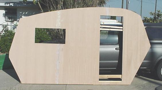

Postby cracker39 » Wed Mar 01, 2006 5:59 pm
Yes, it does have another side...The strips in the doorway are bracing due to the fact that the two sheets only have about 7 inches at the top and 2 inches at the bottom where the edges join, and the bottom has only the temporary 1" strip for floor mounting, which will be cut out after it's on the trailer. So, I had to reinforce the side so it wouldn't break while moving it around.
I wasn't in a big hurry to get this side completely finished, as I was tweaking things. I put both sides together, clamped them, and belt sanded the top curve to get both sides identical. I also flattened the fan area and eased the radius on the front curve somewhat. I thought I'd have to build up the fan mount, but it's such a perfect fit, it will fit flush on the top surface. By the weekend, I should have a good estimate of weight and get the axle on the chassis. I'll also know just what the chassis will weigh. Next week, I'll get the chassis painted and post pics of it finished. I am anxious to start putting it all together, and that shouldn't be much more than a week away that I can move it and begin assembly.
