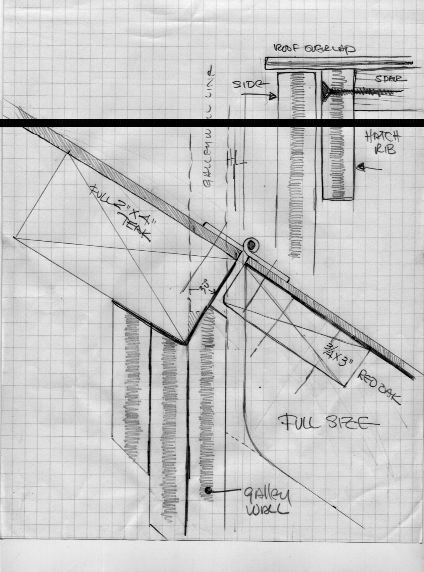

Postby angib » Thu Apr 06, 2006 8:20 am
One problem with your sketch is that the rubber seal gets stretched when the hatch opens - it's tempting to say "it's rubber, it'll stretch", but it's an extra bit of distress applied to it wthat must shorten its life.
The alternative is to put the rubber above the piano hinge, which is not as attractive and then requires something extra to hold the rubber down, so that's not ideal.
I do like the way you've got the galley bulkhead butting up to the hatch hinge beam - so much stronger than just a big beam fixed at the sides.

Postby asianflava » Thu Apr 06, 2006 3:56 pm
Nice drawing! Just make sure you plan for the hatch sealing. You may have to cut a notch in the side since the hinge has no offset.

Postby GPW » Fri Apr 07, 2006 6:56 am
Flava'...Ouch !!! That notch /hinge offset jumped up to bite me in the ... I thought I had it worked out ???? DUH !!!! In such ways are we humbled .... :(
I wonder if dropping the side doubler the thickness of the hatch roof +some weatherstrip would be easier than the notch thingie ' ... doubler thing sounds easier (no cutting ) , but notch allows roof to overlap the sides ... Hmmm??? :thinking:
Ang... I was worried about that too , either a synthetic material or rubber bent (looped under into the slot )to allow for stretch ... Over is exposed and really won't work for me, not in this Sun ...Gotta' be some way to do this ...I could really depend on the weatherstrip sealer in the notch which would be thick enough to compress really well and seal the hatch/hinge line by itself (it was the backup )...
I have a 6 foot stainless piano hinge , that I drilled yesterday every 3".. I really need to use what I have in order to stay in the budget .:roll: hahahahahaha
This is why on the next one (as soon as I get this finished) I'm going with my modern sketch(Flash TD) /porch thingie' /back door type design , eliminates ALL of these silly problems ...and with the right paint job , has all the nostalgic "flava" of a Traditional TD ... ;)
We don't need no stinkin' notches...... hahahaha
Postby GPW » Fri Apr 07, 2006 5:26 pm
You got me before my second cup this morning .... mulled over the sketches all day ... everything's fine ... the skin of the hatch overlaps the sides by 1" and is level with the sides... the notch is already formed by the addition of the skin to the front (body)...side+ 1/4"= notch .. the hatch with the skin on it is level with the rest of the roof ... Viola' !!!
The old timers sealed their piano hinges with a flap of canvas... bet we could find something better ???? and since my hatch/roof is almost a 45deg. angle , I might attach the flap on the high side only ???/ just an idea??... I sure would appreciate if you guys have a better idea... any ideas , I'm running out here .... :?
Ang ... It was the best idea I could come up with .... 3 layers of 3/4" ply just HAS to be strong , and I've got a fine piece of Maple to cut up and use as the body and hatch spars... That should be strong enough eh ??? I've heard mention of the hatch spars breaking ??? What's with that ... wind gusts when the hatch is open ... extremely bumpy roads??? ??? I dunno' ???

Postby GPW » Thu Apr 13, 2006 7:40 am
Here's the latest sketch of the hatch /hinge area for your perusal ,actual size (or close) ... I appreciate the comments ... You can see with the sharp angle (drawn from the wood )I might be able to usa a waterproof Flap-like device over the piano hinge...like the oldtimers did ...Image
