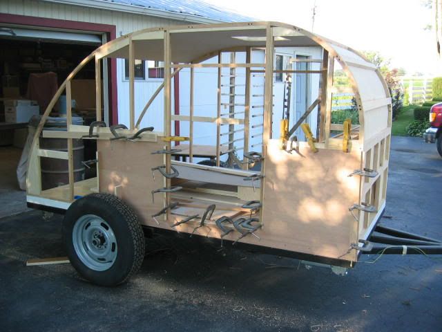

Before I close up my walls and ceiling, I was wondering if anyone is sealing the back side of the walls and ceiling before putting in the ridged insulation. I have the interior ceiling in and just started the walls.

Thanks for the replies everyone. I was gone for a long weekend and just getting back on track. I am just finishing all the outside 1/4" walls. So if I am following your answers I should seal inside the walls. I am useing the pink insulation sandwiched inbetween. Do I try not to seal the face of the interior frames so I get better glue adhesion when I attach my interior walls?
