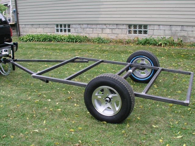

Postby mikeschn » Sat Sep 18, 2004 3:59 am
I like the 2" square tube. Clean, easy to work, and it's completely sealed on the corners!
I primed it with rusteoleum primer, and plan on painting it with gloss black rusteoleum!
