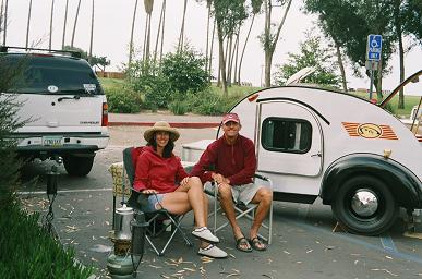

Mine is the same clearance as the (leaf spring) axle, albiet in front of it. Water tank is at the same clearance +/-.
I, too, have my spare, lug wrench, tools, as well as two TV tables in mine.(35" side-to-side x 23" front-to-back x 8.5" deep)
The hatch cover is on a piano hinge & my mattress (actually cut into 4 pc., cut cross-wise) is split in the center and hinged (by using a fabric cover) into two seperate mattresses made up of two sections each, so as to make the "basement" easily accessible by "folding back" the two center sections as you would a book.
Not the greatest illustration, but you can see how far it protrudes down in this pic...

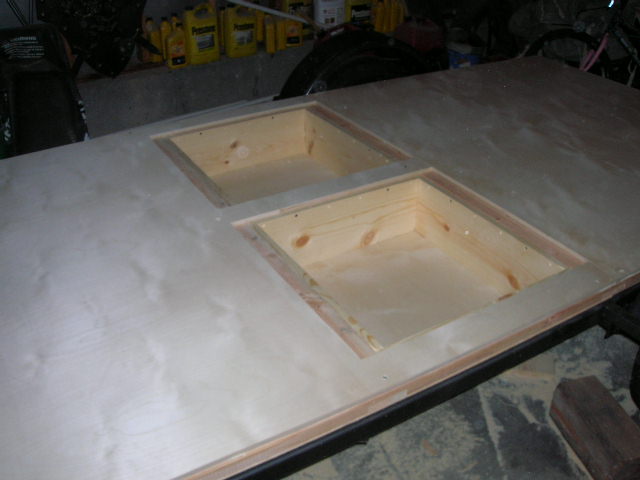

I just screwed my storage boxes to the sandwiched frame members. They were pretty tight and they aren't going anywhere. I have stood in them while building the trailer. They are only as deep as the axel is high off the ground. I don't plan on any real off roading. I have only used one so far, the one closest to the door for storing the leveling jacks I use. I will probably store things I would only need once in a while or extra blankets, etc. They will hold lots of cans of drinks!
