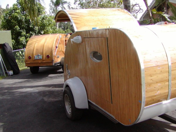

peggyearlchris wrote:8) I love the woody style tears. What kind of ext. wood can I use? Does it have to be exterior grade? How about the thickness of wood? Just haven't made up my mind yet, to paint or varnish.. help please![]()
Peg
Ira wrote:My sides are 3/8" ply, skinned with 1/8" "beaded" birch. (I didn't know what beaded meant until Woody told me--it's just birch with channels cut into it.) My roof is 1/4" bendy birch.
I didn't stain--just used 4 coats of Vitralite Marine Saper varnish (Pratt & Lambert brand). The stuff is VERY expensive, like $30 a quart, but it's rated for 30 years of UV protection with 3 coats. The varnish alone gives a tone/color to the birch, so unless you want something darker, you don't have to stain.
Although I didn't anticipate it, using regular cheap ply for the sides and then skinning with the finish wood came with a great benefit for a spastic builder like me--I didn't have to worry about nail/screw heads and other problems with your wall wood, since you're going to slap the skin on there anyway to cover it.
The roof is just 1/4" birch with nothing under it.
To each, it's his or her own taste, but to me, unless you're going to skin with aluminum, it's woody all the way. Most of these TD styles have an antique look to them, like something from another era, so I really prefer the wood look.
apratt wrote:Woody on your first trailer I see what appears to be a pipe on the side of your trailer? Or is that a anttennae?
