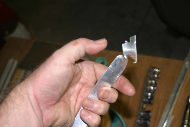

I had a little accident yesterday, and my guardian angel let me off with another warning. I still have both my eyes and ten working fingers. I was cutting some 1/6 aluminum flat with the chopsaw and at the end of the cut, the saw grabbed the aluminum and before I opened my eyes to do a digit check, all I could think was "Will Madjack really want to see these photos?"
I was extremely lucky. All I suffered was a bruised and nicked thumb and a botched piece of trim. It could have been soooo much worse. I put myself in "time out" (I frequently yell and scream at myself when I catch myself doing something really stupid!) and it got me to thinking about the danger of trying to use woodworking tools to do metal working. I know it can be done, and lots of you out there have probably done it on a professional basis. All I can say is that it is my opinion that woodworking tools should not be used for metal work, but if used for that (and I will be guilty of continuing to do so) extreme care should be taken to make sure the piece you are machining doesn't end up causing your body harm.

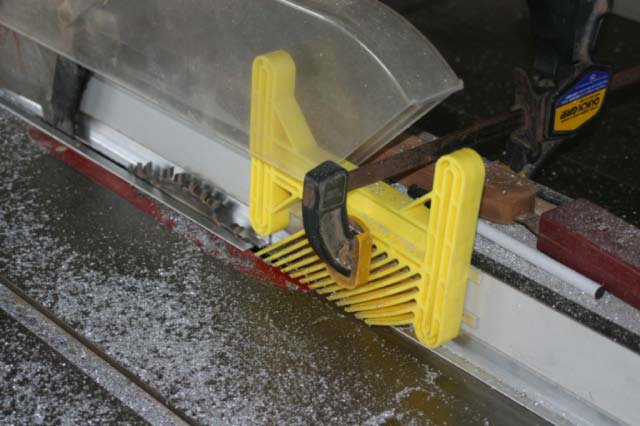

My limited suggestions--foremost, always use a full face shield, long sleeves, and if possible, gloves. Use backing blocks and feather boards where necessary. When ripping angle on a table saw, drop in a zero clearance blade insert, and use feather boards.

Another little hint about ripping and cutting aluminum on the table saw would to keep the blade height down as low as possible, just up enough to complete the cut, no higher. If you try it, you'll enjoy less chips flying around above the table, less opportunity for the blade to grab the workpiece, and less chance of binding on the blade.

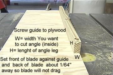

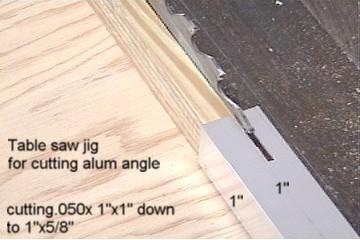

I have had my share of mihaps cutting thin alum. Now I always use wood on both sides of alum when using the chop saw. When I use the table saw i try to make a wood jig.
This is what i made to cut the leg off angle. It worked fine but it would have been better to have back up for the scrap piece Too.
Tony I tried cutting the leg off my angle the way your pic shows. the scrap piece went down into sawblade slot and really tore things up. thats why i made the jig below.
