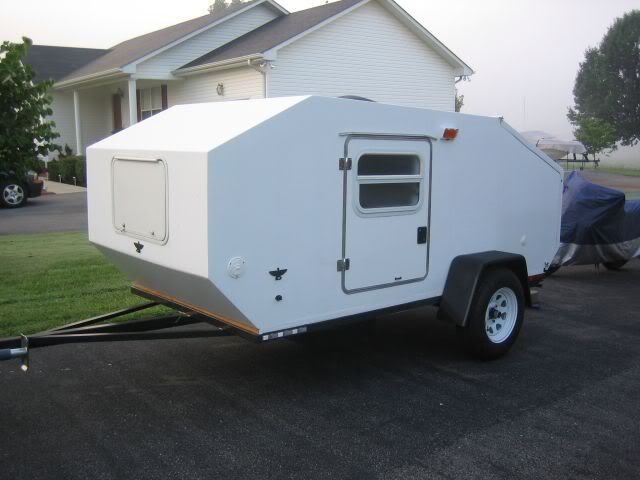

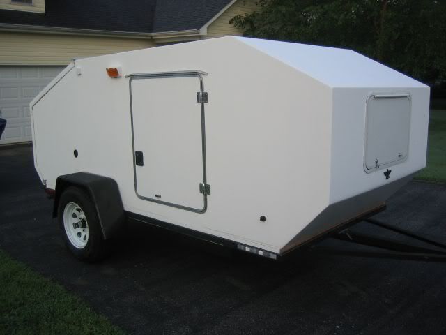

It has been awhile since I posted and I have been on a one week build frenzy. I have not completed my in-cabin and in-hatch cabinetry, but it is all useable with sliding AC, LCD w/DVD, roof vent, gas cook top and slide out cooler. Here are some outside photos. The curb side window will be installed when I return.

Postby Loader » Wed Aug 23, 2006 9:34 am
Looks Great :applause: :thumbsup: :applause:
Have a great time out at the race!

Get used to showing it because everyone who sees it will want to see more. Great job! :thumbsup: :applause: :applause:

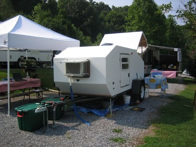

Can you post pic's of the A/C install or are they someplace else? I remember some, but if it is the one on a slide I would like to know how it traveled and how you mounted the slides! Also how you drain the pan?

EXCELLENT! REALLY CLEAN BUILD!

The AC slide-out worked great, except for the water in the pan after the first night. I have a great drain system for onsite, but there is some residual water in the pan that ended up on the front edge of the mattress. I'll find a solution for this.

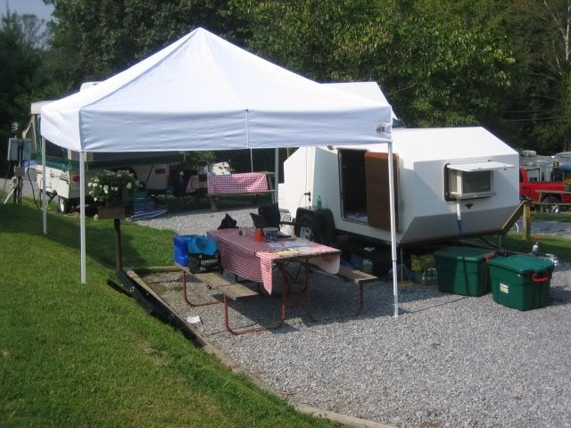

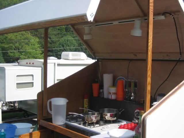

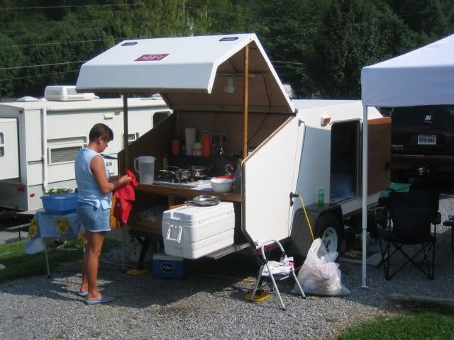

Here are some site photos!
The AC uses a RV access Hatch (Ebay), HD Drawer Slide-out (24", Lowes) and Garage Door seals, cut on a chop saw, with a 6,000 BTU AC unit, it is worth the extra cost for the digital controls and remote.
I do the cooking, but I don't do dishes!

Postby TRAIL-OF-TEARS » Fri Aug 25, 2006 10:23 am
Bandit,
That is one heck of a cook top, I like that a lot. The TT looks great hope yall have fun with it. :thumbsup: :thumbsup:

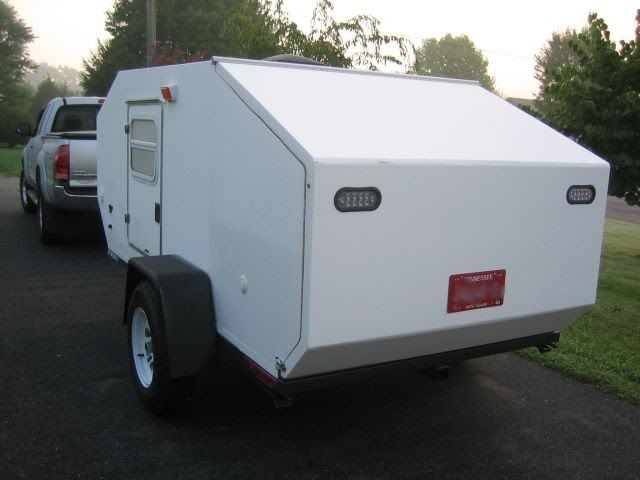

P.S. Do you have a light for your license plate? I don't know if that is a law in your neck of the woods, but I shure would hate for you to get a ticket for that.

The license plate is actual a friends Dealer tag as I have not had time to register it yet, and it is over 80% covered by a hitch rack and Hitch Haul dry box. The plate is there only to keep me from being pulled over with NO plate!
