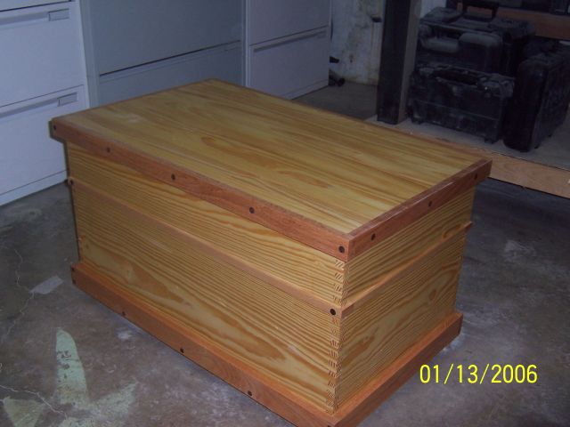

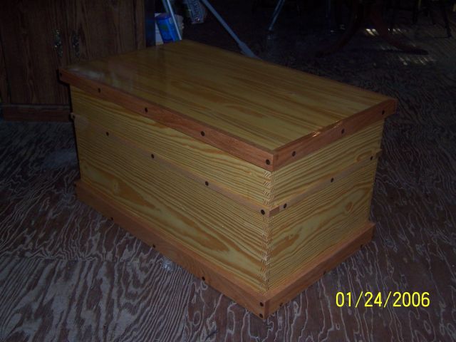

I am a cabinet maker (now. I used to do home remodel) I keep a big box of crayons in my tool box for filling holes and touching up any gaps in laminate seems. The big box has alot of colors.(
I also have used wood plus to hide screws. You can't really hide them so they disapear(sp?)so I like to use a contrasting wood plug to make it decorative.
I recently finished a bed (actually the trundle portion) for my mom. made out of clear yellow pine with walnut plugs to cover screws and as a decorative touch. I also used the same method to hide some screws in 2 blanket chests I made last christmasfor my dad and one of my brothers.
They wer made with yellow pine cases with red oak trim and walnut plugs they turned out great.

Postby Andy Ehle » Tue Sep 05, 2006 8:27 pm
with only the screws covered
with decorative plugs installed
It now has 2 trays that sit on the oak divider that seperates the top and bottom portions of the trunk
