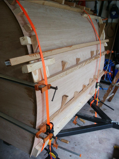

Postby Steve_Cox » Wed Sep 06, 2006 9:21 pm
Mike
Here is a picture of 1/4 inch oak, and less of a radius. Like comparing apples and oranges I guess. I just used epoxy to put it on, no screws, nails or staples.
Steve

Postby stjohn » Sat Sep 09, 2006 9:49 pm
WELL 5.2 MM luan will bend around a 15" radius but it's tough the first piece broke (that means a nother trip to lowes)the 2nd we wet very much along the bend put some strips down along the spars worked our way down it only made nois once in the middle of the bend Now how long should I leave it bent before I remove it and install it permently here is a pic of the bend team (I had to feed them all tacos before they would help me pretty cheap labor though)
