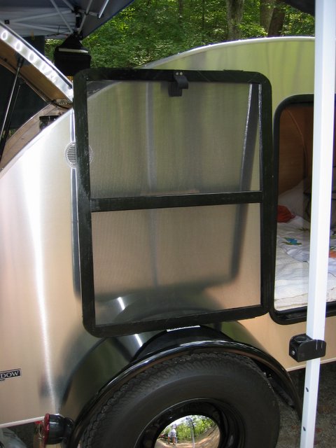

We built some screens for our doors that cover the entire door area. A few 1x2's and some screen and screen cord. We lapped the joints on the 1x2's and screwed and glued them, and then used a jigsaw to round the corners to match the door frame. We cut grooves in the 1x2's with the table saw and it was just the right width to accept the screen and cord.
We made a cross brace for the center (inside and out), with a homemade handle on the inside to make it easy to hold on to.
We put self sticking velcro on the door frame and the door so they are very easily removeable. The velcro is not on the face of the frame, but on the edges/ends, so the heigth tolerance had be pretty close. Made pull tabs with an old web belt we cut and screwed on the top, both inside and out. You place the screen at the bottom inside the door frame on the velcro, then just pull it closed at the top to meet the top velcro. From the outside, just pull the tab on top and out she comes.

This shows the screen in place.
Here is a view of the inside of the screen.
Here is the outside of the screen
