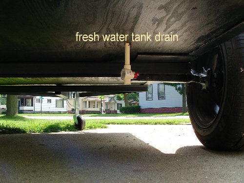

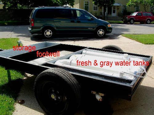

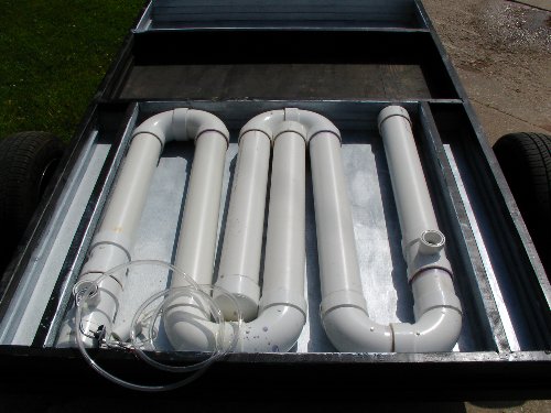

Postby BrwBier » Sun Sep 10, 2006 7:31 am
I was inspired by Mad Jacks water tank. I added some ideas of my own and came up with this setup which works quite well for me.
It holds about 7.5 gallons of water in each system.
