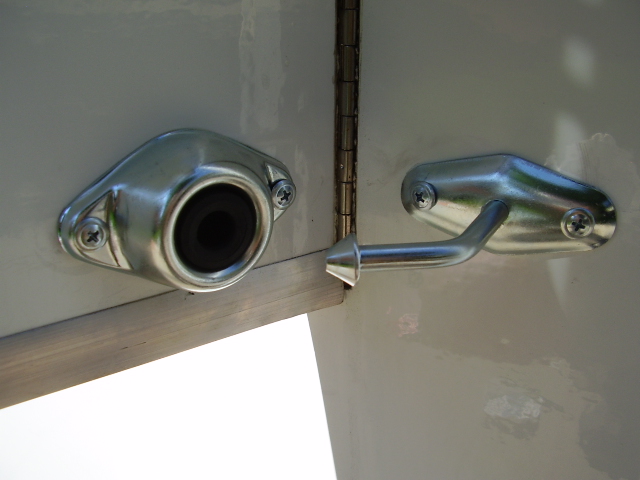

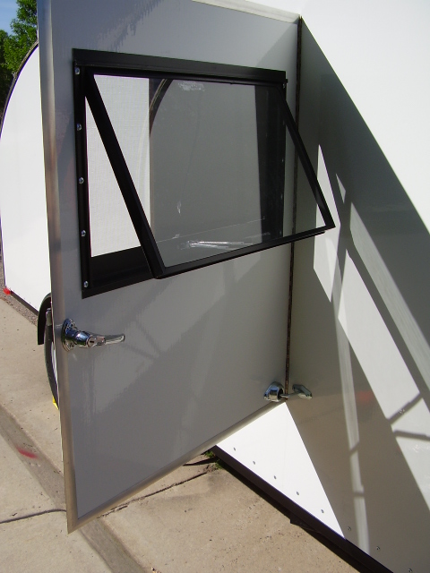

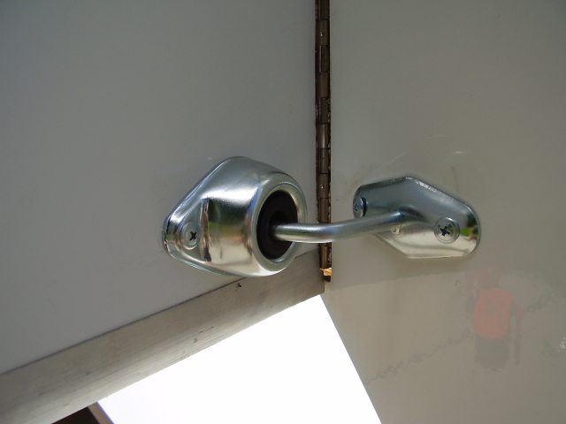

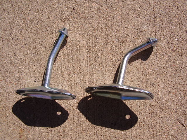

Postby Gerdo » Fri Sep 15, 2006 4:53 pm
I saw a picture that halfdome had posted of his door props. They looked tike they would work for me. I have Grant's flip out style windows in my doors and to keep from crushing them when open I had limitting straps on my doors. This kept them from opening too far but I didn't have anything to keep them open. These door props do both so I removed my limitting straps. I had to bend, modify the pins.
Now even with the window open full there is clearance between the window and the Teardrop.
