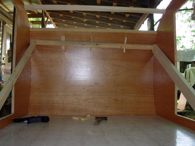

Jim, here's one way. I used a 2X3 piece of scrap, attached 2X4's to each end, braced the 2X4's at my fender wells then used wedge shape pieces of scrap as shims to insure the ceiling is tight against the spars. Use as many braces as you need, or have spars. Usually one or two in the curve will hold it pretty good. If your floor is finished already that may be a problem finding a way to hold the brace without marring the floor. If unfinished just temporarily screw some scrap blocks to the floor to act as chocks. You can't see the base of the brace legs in this pic but it's about as I said above. Or, you could make & use a "T" brace which is essentially the same with just one leg in the middle. The bottom of that first ceiling panel is screwed/stapled to the first spar.

Postby kayakrguy » Thu Sep 28, 2006 6:22 pm
Dan and Harvey,
Yep, from the inside, though I can still squeeze stuff through spars etc (no roof yet...
And, yep, floor already finished and would like to NOT put holes in floor to hold chocks etc. However, the flexible/bendable thing made me think of using my ratchet straps through the doors and around front of trailer to hold 'chocks' in place and then use the flexible bendible stuff to create pressure on the ply.

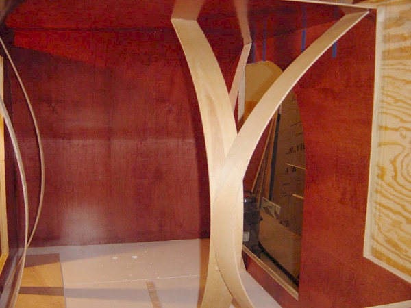

Postby Endo » Thu Sep 28, 2006 7:16 pm
I cut some strips of 1/4" ply a few inches too long.
When wedged in place they held pressure on the panel.
I also used some brad nails to hold things in place while the glue dried.

Ed and Endo, thanks for the ideas and Endo I gotta say, its too bad you had to take the braces down--they looked like something Calder would have done--really graceful!
