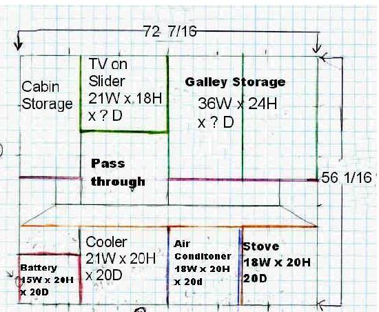

Well now my total lack of experience is gonna show. These books don't show cabinets like I have seen here and they are way overdone. SOOOOO
1. How much framing do I need to manage this hoped for end product.
2. And should I still do the stick framing for the galley wall? :NC
3. How deep should I make the upper cabinets?
4. How do I attach the cabinets to the framing and have them not rattle off going down the road. :?
The counter is 20" deep.
My picture leaves a bit to be desired. Hope it is not too confusing. :oops:
Any advice is greatfully appreciated.

Miriam, First it is advisable to decide what kind of hinge you desire. My galley cabinets are frame less and my cabin are face frame cabinets. In the cabin I wanted the more polished traditional look so I went with 3" stiles to clear the light switches on each wall and it looks nice. In the galley I was challenged for space so I went frame less but I was able to use the same hinges for both types of cabinets. I used a brass mortise less flush hinge that has a very nice finial from Rockler. When laying out your galley consider the counter height from level ground. My upper counter is 42" which is bar height. My lower pull out counters are 36" from level ground just like in your kitchen at home. I also laid out the components to create a small working triangle just like many home kitchens are designed like. I would lay out your galley full size with cabinet members included as your components only leave 1/2" for cabinet ends and dividers. You'll need them to hang your doors on. You will be more comfortable with a well laid out galley. :) Danny
Make a full sized layout of the galley wall. That layout is a piece of 1/2" particle board just sitting in my galley, it is not affixed.
Pocket screws work great if you make face frame cabinets. You can make your cabinets on the bench and squeze them in between walls or build them in place. I prefer to build them on the bench. :) Danny

Postby Miriam C. » Thu Sep 28, 2006 11:36 pm
Great picture Danny. Thank you. That will fix how to design my upper cabinets. And get the depth right.
The counter is as low as it can go and still get a cooler in. It is tall for me but I can use a table for most things. Ends up at 41".
My wall is flat on the cabin side and originally I had planned to frame all in with 1 x 2s but it sounds flimsy now. I have 1/4" birch to face one side of the wall but don't know how thick I need the on galley side to be sturdy enough to hold the top cabinets nor how to attach them.
Did you just frame out (like a skeleton) or did you frame out of plywood, (boxes) and how thick.

Postby halfdome, Danny » Fri Sep 29, 2006 9:40 am
Miriam C. wrote:Great picture Danny. Thank you. That will fix how to design my upper cabinets. And get the depth right.
Do you really need to put the cooler in the galley? When we travel it's inconvenient to go to the galley for a cold drink when it can be carried in the tow vehicle. To me it is very important to have a comfortable working height for the counter top.
You can cleat your frames if you are planing on face frames. With your measurements it looks like frame less would be the way to go with some type of butt hinge like I mentioned before or spend more $$ on cup hinges ( European) but they are more difficult to install and take up some room in width.
My galley cabinets were constructed from 3/4" maple veneered plywood (ends & rails & no backs) and the raw plywood edge was banded with 1/4" x 3/4" solid wood to match my door wood. You can easily do the banding by cutting the strips a little wider and glue and hold in place with masking tape every inch or so then sand flush. You could do this to your doors too.

Postby Miriam C. » Fri Sep 29, 2006 3:31 pm
Thank you Danny,
I hope I understand cause I'm on it this weekend.
Everything I need in the galley is 17" to 18" tall. The galley is 6 feet wide and 4' 6" tall (Useable). I really need the extra weight in the galley. I made it all too light and with the bed up front the galley is way too light.
The floor of the trailer is 21 inches off the ground. The counter is as low as I can get away with and only allows for side mount slide outs.
The back wall---Anyone know how thick it needs to be to support the weight with the TV in it's box?
The first hings is great. Is that the kind where the door fits inside the frame?
Postby halfdome, Danny » Fri Sep 29, 2006 7:31 pm
Miriam C. wrote:Thank you Danny,
My back wall is 3/4" thick Red Oak plywood with plam on the galley side. when I made my walls I made a 3/4" slot to receive that wall. I just pocket screwed it to the floor where it won't show. I did it the same with the headboard face frame. It gives the tear some integral strength. :) Danny
