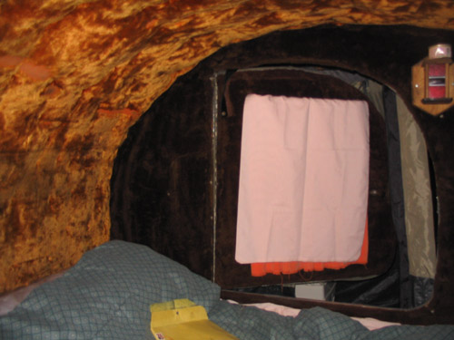

Postby Ma3tt » Sat Sep 30, 2006 8:08 am
I've been meaning to get this picture up. and this is a good time.
this is a 47 Kit like mine all crushed velvet and shag. Bright yellow exterior, the guy who owned was hilarious. Spamboree '05

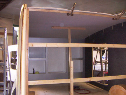

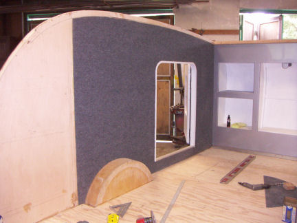

Postby Gaston » Sun Oct 01, 2006 8:38 pm
I covered the ceiling in RV headliner material and the side walls in short nap light weight carpet. Light weight ,easier than painting and reasonably cheap to do.

Postby Gaston » Tue Oct 03, 2006 4:59 pm
Hi cablerunner
I used brush on contact cement on the sides and spray contact cement on the ceiling. both were done flat on the bench to make controling the fabric and glue easier ;)
