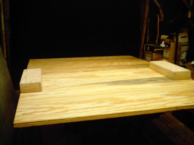

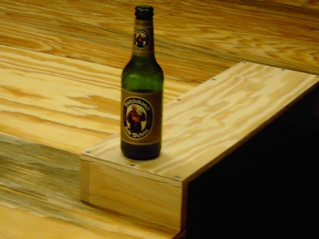

I got the fenderwells finished tonight. I used pocket hole screws to attach the frame of the fenderwell to the floor, then used counter sunk galv deck screws to put the "lid" on. :) All with plenty of glue. I'll next tar the inside of them and will be about ready to attach the floor to the frame. I've been waiting about 3 days on drying of the floor, I sanded and then used boiled linseed oil for a first coat. Oh I love the smell of boiled linseed oil! :R That stuff takes a long time to dry but it really gets into the fibers of the wood.

Postby bdosborn » Wed Oct 18, 2006 9:29 pm
Hey, I used to have a green hammer like that! I went through a bunch of them because they broke so easy. Funny thing though, I kept buying them.
:lol: :lol:
The floor looks good too. :thumbsup:
