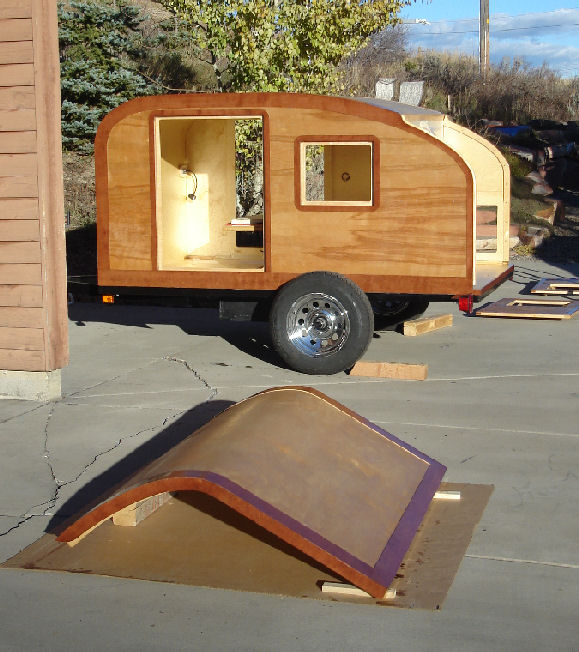

I sealed up my trailer today with CPES cold weather formula (only got up to 47 for the high). Now I'm trying to decide what to put over the top of it for UV protection. I've read that automotive clear coat is low maintenance compared to varnish. Low maintenance is good. My trailer will be stored outside, so I need something highly durable, although I'll probably have a cover made for it. Now for the questions:
Can you get a decent finish by using a brush to spread the clear coat? I've never used a sprayer nor do I have one. I'm not Doug, so am not looking for a mirror finish, just something that looks nice and holds up well.
Would I need more than one layer for good UV protection?
I don't think we'll be seeing temps above 50 again till spring. Can it be applied in cool weather?
Any particular brands that people like?
Thanks,
Jeanette
And of course, here's the requisite picture:
