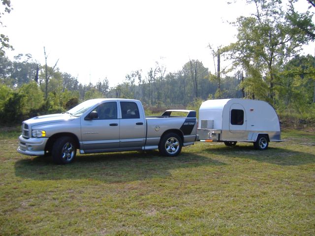

Postby stjohn » Sat Oct 28, 2006 6:55 pm
like this
the only down side is the ac running by your head I still have to put a bracket
down to the frame

Postby harldydodge1 » Sun Oct 29, 2006 11:30 pm
Hey John,
I put the A/C in the front of my TTT then installed a tool box under it for support. This worked good until I pulled it for the first time and noticed that condensate from the unit would blow back inside the camper. I had some diamond plate left over from the sides so I built a cover that is hinged at the top and is opened when I use the A/C. It seals out the wind and also helps protect the coil when on the road. Also the tool box came in handy to use for all the electrical equipment, battery and for added storage. Here's a couple pictures. Wish I had a better picture . Keith
