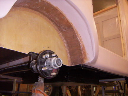

Postby Gaston » Tue Nov 21, 2006 2:18 pm
I made them from 1/8" luan, formed over a barrel end, then glassed on the outside, removed from the barrel and glassed the inside, trimmed to fit and glassed in
Image[/url]
a good project to learn how to work with fiberglass

Postby apratt » Tue Nov 21, 2006 2:34 pm
Gaston wrote:I made them from 1/8" luan, formed over a barrel end, then glassed on the outside, removed from the barrel and glassed the inside, trimmed to fit and glassed in
Image[/url]
Gaston I liked the way you did your wheel wells, very nice work. :thumbsup:

Postby Hudsonite » Wed Nov 22, 2006 5:47 am
Wow! Those are simply outstanding. Thanks so much for the tip.
