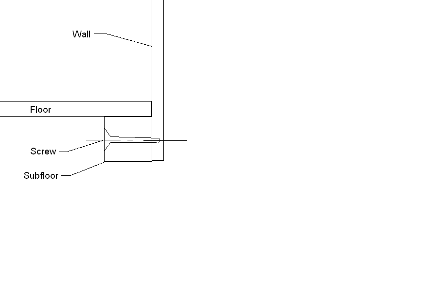

Postby Creamcracker » Mon Nov 27, 2006 8:51 pm
Ok, so I make my floor just like the one pictured and bolt through that to attach to the frame but how do I attach the sidewalls? I dont want to screw from the outside walls through into the wooden floor frame 'cause I don't want the screws to show on the outside since I might finish it with a clear varnish over the plywood facing. If I screw from inside the framed wood floor into the backside of the side walls will that be strong enough? Guess I'd have to do that lying on my back from the underside. I don't want to come right through obviously -- I guess I could glue it also. What would be your advice?
Philip
Creamcracker
Teardrop Graduate
Posts: 1126
Images: 142
Location: VA Culpeper
Postby mikeschn » Mon Nov 27, 2006 8:57 pm
Yes, you can glue it and screw it from the inside.. it's not the best situation, but if you use good stainless screws, with threads all the way to the tip, it should work.
you drill a clearance hole in the 2x2 sub-floor. I don't know how thick a wall you are planning, but if you have a 3/4" wall, a 2" long screw should work.
also put a bead of titebond III on the edge of the 2x2.

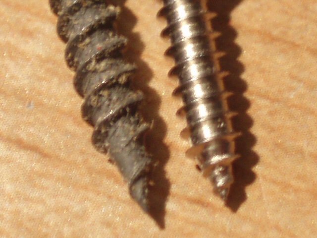

Postby mikeschn » Mon Nov 27, 2006 9:32 pm
sandman wrote:Anyway, on screwing the floor to the 1x2 frame, do I screw from the top of the plywood down into the 1x2?
YES!
sandman wrote: I bought zinc plated #10 1 1/4" screws but the thread don't run all the way to the top. They run about 95% of the way and then it's smooth. Will these screws be ok?
You want as much of the tip to have good thread... since you won't have full engagement in your oak. The SS screws on the right, for example, would be a better choice than the drywall screws on the left...
