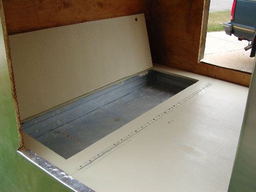

Postby Miriam C. » Wed Nov 29, 2006 10:37 am
War Eagle here is a picture of Nitecap's underfloor storage for his kites. If you find any post made by him you can see the entire build. He is making great speed.
The other issue is when you put your floor off the ground 12 more inches you need to jump to get in. ;)
Postby War Eagle » Wed Nov 29, 2006 11:03 am
Gotcha', I miss understood about the 1x's. Your right, and from looking at the pic you provided that may be all I need as well. 6" under the floor is alot of space.

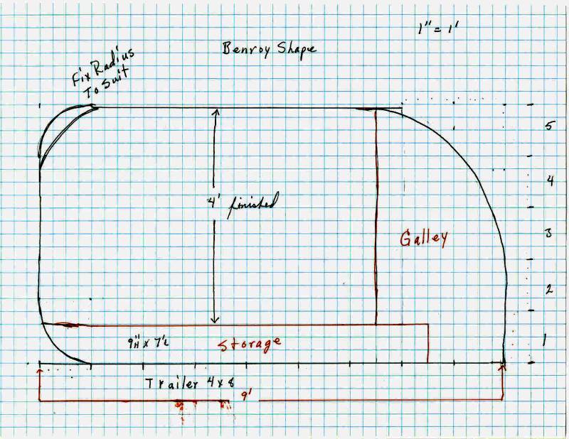

Postby Miriam C. » Wed Nov 29, 2006 2:10 pm
Kens wrote:Don't forget it's very hard to get to under the bed. Sorry I built under bed stoage.
Here's one we were tossing around a few months ago. It can be adjusted to go all the way to the back and a drop door for access.
the original person didn't want the back deck 9" higher so the access was to be from the side or front.

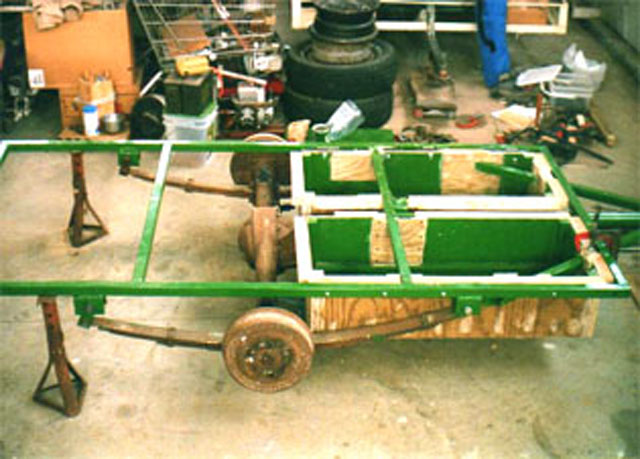

Postby gyroguy » Thu Nov 30, 2006 10:16 pm
I had considered full-length storage just like you're talking about.
When I drew it out, I saw two things. First, there's room UNDER the frame for boxes. Second, if I put the boxes under the front half of the frame only, that would help get me keep the weight centered ahead of the axle.
I built boxes around some frame members to get maximum width and length. The lids are between the first two frame members.
I have 3 folding chairs, a lantern stand, a tent, etc. in just one of these boxes. both boxes together total 3.5 cubic feet of storage space.
Only gripe is that the boxes took a long time to build and fit.
(The ancient Chevy truck rear axle has been replaced.)
[/img]
