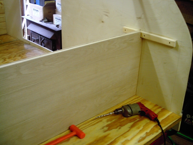

I skinned the rear bulkhead frame, using 1/4 inch birch ply.

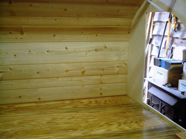

I put the first piece of headliner skin in, 1/8 inch knotty pine paneling.

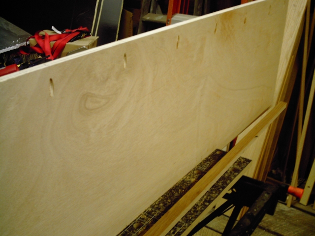

I used the pocket hole screws to attach the front edge to the countertop, used the 1 1/4 inch fine thread ones and lots of Titebond glue.

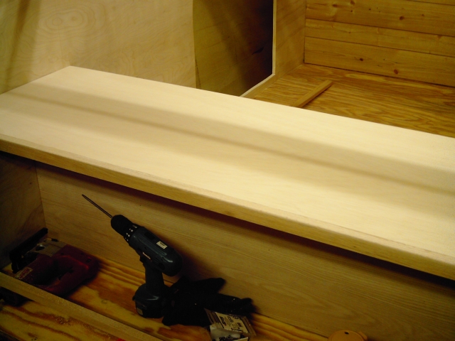

Here is the countertop just set in place. I'm going to stain and finish it before I secure it in place.

That knotty pine was the best looking 1/8 inch wood that Lowes had. It looks so real! I've been trying to keep the finish color light inside, makes for a larger feeling to me.

Love that notty pine. I am glad you posted the counter top so I could see a better way to trim it. 8) What kind of wood are you using for it?
GitRdun
Thanks ;)
I'm thinking the wood is a cabinet grade birch, 3/4 inch. The front edge is more of that hard oak that was leftover from handrails. Free stuff. :thumbsup: :thumbsup: :thumbsup:
:scratchthinking: er.... is the knotty pine paneling or individual boards? The 1/8" caught my attention.
EDIT: Duh :duh I'm a Tard!! I just now read your captions on the pictures, and yes it is paneling.
