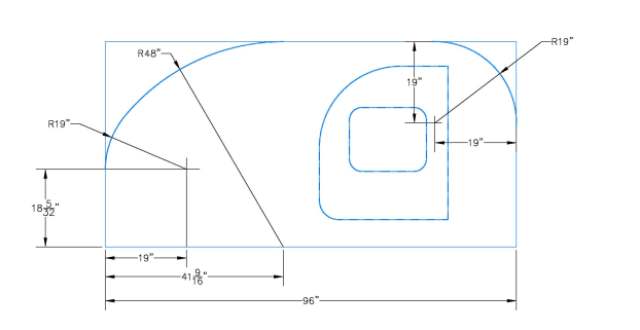

Postby War Eagle » Wed Dec 13, 2006 12:55 pm
On page 17 of the Generic Benroy Plans I can see the starting/ pivot point for the rear 19 and 48 inch radius' but I do not see the starting/ pivot point for the front 19 inch radius nor for the door. Does anyone know or can anyone figure out what that pivot point should be?
Thanks in advance for your help.
War Eagle

Postby greglaw » Wed Dec 13, 2006 1:01 pm
19" down ...19" in.

Postby Mary K » Wed Dec 13, 2006 1:37 pm
Here is my drawing I did. Just right click, save and print from your pc.
Hope it helps.
Mk

Postby War Eagle » Wed Dec 13, 2006 2:28 pm
:? I'm so dumb, now that I see it that was simple. Thanks guys and girls.

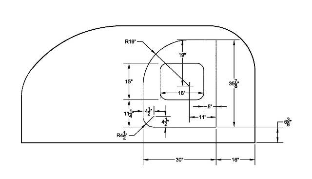

Hey, I must be dumb too. That drawing really helps when doing the top front radious but I STILL don't see where the pivot point is for the door radious. :thinking:
I'm sure someone will be glad to point out my ignorence!! :lol:

Postby SaGR » Mon Jun 11, 2007 11:23 am
It'd be the same as the front, 19" from the edge of the door and 19" down.

Postby Mary K » Mon Jun 11, 2007 2:27 pm
Here ya go.. I added a curve in the bottom rear corner on my door.
Mk

Postby SaGR » Mon Jun 11, 2007 2:32 pm
So on yours the plot point is 19" down from the top of the door and 11" in from the leading edge of the door.
Gotcha

Postby Mary K » Mon Jun 11, 2007 3:27 pm
SaGR wrote:So on yours the plot point is 19" down from the top of the door and 11" in from the leading edge of the door.
Gotcha
11" one way...19 the other , I just put the dimension on the other side of the mark.

Postby SaGR » Mon Jun 11, 2007 3:32 pm
Looking at your drawing it's clear.
I was just trying to put it in "Engrish" for the next person that searches for it. :)
