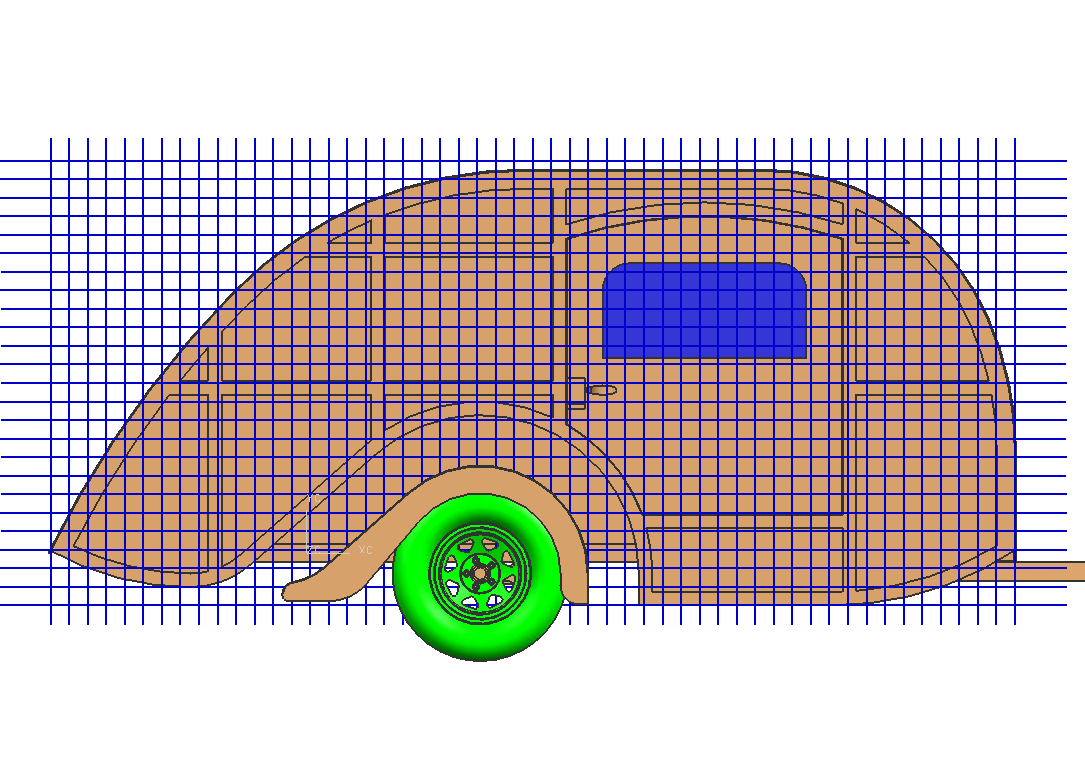

Hi,
I'm a newbie embarking on making a larger version of a slumber coach. I have a 13 foot trailer by 6'4. I'd like to make the side profile to be proportionate as possible to the original. Is there anyone who could easily alter the original design from the library to give me the new demionsions for my sidewalls? Just glancing at it I thought I would go roughly 1.75 times the overall height which should put me around 7' high at the peak. any help or suggestions would be greatly appreciated. I'm hoping to work on it this coming holiday weekend.
Wood Tick :thinking:

Postby mikeschn » Thu Dec 21, 2006 5:56 am
Woodtick,
I took the slumbercoach and did a quick stretch for you. I stretched everything but the wheels and fenders.
I put a 3" grid on the results so you can transpose this to a piece of wood if you like.
Naturally, you'd have to do a little bit of design work yet, especially around the fenders, but you get the general idea.
Now it's off to work I go!!!
http://www.mikenchell.com/images/slumbercoach13ft.png
